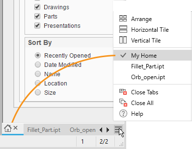

Documents can display in one or more windows in one or more monitors. When Inventor starts up, the default window is "My Home" and the tab displays this icon
. You can turn off the default display in Application Options, on the General tab. The documents tab menu displays the window layout options and the active document.

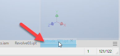

Add a document to the window by dragging a document tab into the tab bar until the blue frame edge previews below the tabs, then drop it. The document window remains a single document type.
Create a tab group by dragging a document tab into the tab bar next to another document until the blue tab preview displays, then drop it. The documents share the window frame.

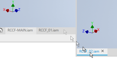

Create a new application window by dragging a document tab and dropping it in the graphics display, desktop, or another monitor.
Create a new application window set
by dragging the set tab bar out of the main window to the graphics display, desktop, or another monitor

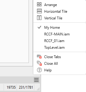

You can create window layouts using the Documents menu at the right end of the window tab bar.
If the windows are tiled, resizing affects all windows equally.
To resize adjacent tiled windows, click-drag the frame between the two document windows. Both windows are resized at the same time.
