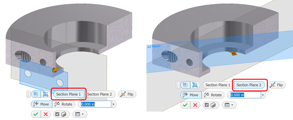

Create Quarter and Three-Quarter Sections
  1. Click view tab Appearance panel and then select a section view type:
    • Quarter Section
    • Three Quarter Section
  2. Select any plane or planar face as the first cutting plane.
  3. Right-click and select Flip, if necessary, to change the direction of the section.
  4. Drag the plane or enter a value in the field to change the position.
  5. Right-click in the canvas and click Continue.
  6. Select any plane or planar face as the second cutting plane.
  7. Right-click and select Flip, if necessary, to change the direction of the section.
  8. Drag the plane or enter a value in the field to change the position.
  9. Right-click then select:
    • OK to apply the section.
    • Flip to change the direction of the section.
    • Three Quarter Section View to change the section view type.

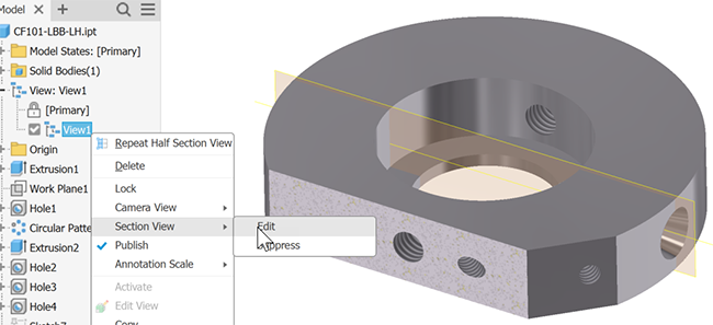

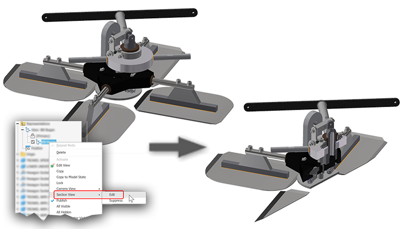

Edit or Suppress a Section View
  1. In the model browser, right-click the view representation having the section view you want to edit and click Section View > Edit.
    Note: You also have the option to suppress a section view.
  2. Using the in-canvas tools, modify the section view definition.
  3. Click OK to apply the view changes.

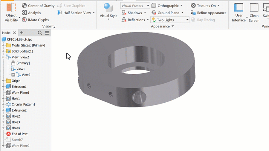

Delete a Section View
  1. Activate the view representation having the section view you want to delete.
  2. Click View tab Appearance panel Delete Section View . The model returns to the normal view.
