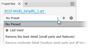

  1. In the Assemble tab Simplification panel click Simplify. The Simplify property panel displays.
  2. Optionally, select a built-in preset to use. Four built-in presets are provided, plus you can create your own. Presets assign values to the fields further in the property panel. You can override any value.
    • Remove the least detail (small parts and features) - the settings are designed to remove small parts and features, resulting in the most detailed model.
    • Remove moderate detail (medium sized parts and all listed features) - the settings are designed to remove a moderate amount of detail.
    • Remove the most detail (replace top-level components with envelopes) - the settings are designed to remove the greatest amount of detail resulting in very basic shapes.
    • No Simplification - the simplified version is full fidelity with respect to the assembly model. All details are visible in the model.
      Tip: Select a preset close to what you want for detail, then use View Included and View Excluded to quickly select the remaining parts to expedite the process.
      The same method can be used for creating your own presets. For more information see To Work with Presets.

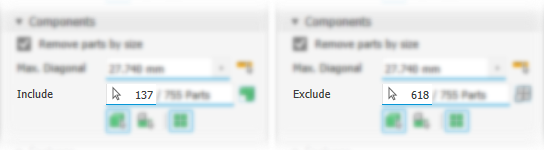

    • Exclude parts by size
      1. Select the Exclude parts by size option.
      2. Specify the maximum diagonal value for a bounding box. Parts or components that fit inside the bounding box are excluded. Use one of these methods to specify the size:
        • Enter the value in the Max. Diagonal edit field.
        • Click the arrow at the end of the value field to select a recently used value.
        • Click the measure diagonal bounding box button then select a part/component to supply the diagonal value.
      3. Click the selection priority you want to use. Choose from
        • Part Priority
        • Component Priority
          To select all occurrences of the selected item click the All Occurrences option.
      4. Auto-detect locates and highlights the components.
      5. Continue selecting remaining components as needed to exclude them from the simplified part.
    • Click View Excluded to see the components that will not participate in the simplified model or View Included to see the components participating in the simplified model. When you view in either mode, the numbers displayed in the edit field are relative to the label.
      Note: Parts excluded explicitly are highlighted when you view Excluded. Parts excluded by size are not highlighted. Viewing options also work with envelopes.

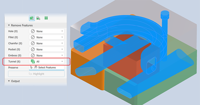

  6. Remove Features provides options for selecting features by type and size to include in or exclude from the simplified part. The list of features include holes, fillets, chamfers, pockets (subtractive), embosses (additive), and tunnels (single and multiple entry). Internal voids are automatically removed.
    • Pocket recognizes subtractive features such as extrudes, revolves, sweeps, and so on.
    • Emboss recognizes additive or positive protrusions of various feature types.
    • Tunnel recognizes a set of faces contained inside the model that define an open area, having one or more entrances to the area from exterior faces.
      Note: Use Tunnel to remove slots.
      For each of the listed feature types specify which you want to remove and the way you want to remove them:
    • None (default) - no features of this type are removed.
    • All - all features of this type are removed.
    • Range - all features equal to or smaller than the specified parameter are removed. Specify the value that defines the maximum size to remove.
    • Preserve - click the selector and select the features you want to retain from those being removed.
      Note: The rules for feature recognition are minimal allowing for crossover, for example, holes also meet the definition for tunnels. Thus, some holes outside of a range may be removed as Tunnels. To resolve this, you can click Preserve and select any feature you want to remain in the simplified part.

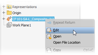

To Edit a Simplify Substitute
Substitutes are model states based on a simplified model. They are added to the assembly and placed in the Model States Substitutes folder. To edit the simplified substitute:
  1. In the browser, expand the Model States Substitutes folder.
  2. Right-click the Substitute you want to edit and click Activate. The model updates to display the substitute.

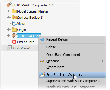

  3. In the browser, right-click the substitute model and click Edit.
  4. In the browser, right-click the and select Edit Simplified Assembly.
  5. In the property panel, modify any of the following as needed:
    • Initial State - select a different model state, design view, or position view
    • Envelopes
    • Components - include or exclude additional parts
    • Features - add or refine the parameters for features being removed
    • Output Style
  6. Click OK. The substitute updates.
