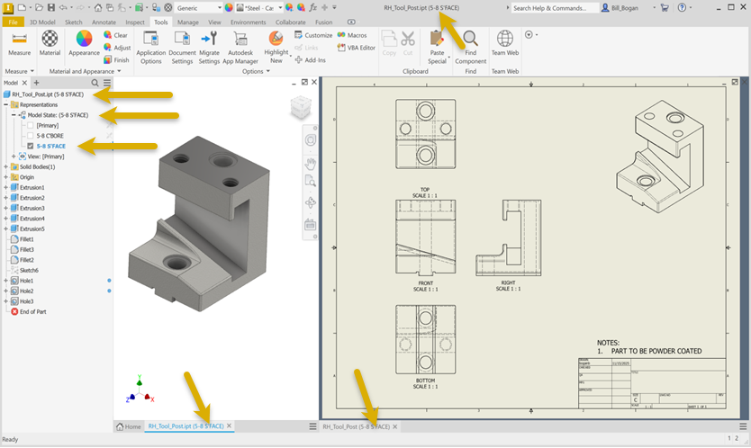

Model States
Show model state scope sets the display option for the model state scope label across the application.
Show model state
