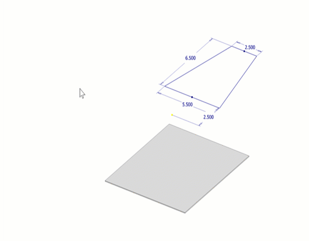

Add thickness to a sketch profile to create a sheet metal face. The following illustrates creation of a base feature and a separate solid sheet metal face.
The first feature that you create is the base feature. For subsequent sheet metal faces, when one line in the profile is coincident with an existing sheet metal edge, a bend is created automatically.
Note: Specific options relate to the base feature. Subsequent face features have additional bend and edge options are not available for the base feature.

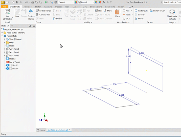

Add Faces to Existing Solids
The Sheet Metal Property panel displays additional parameters when adding face features to existing sheet metal features. Single bends are created by default when you use the Face command.
