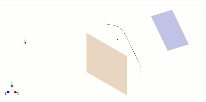

Create a base feature contour flange
Contour Flange as Base Feature
  1. On the ribbon, click Sheet Metal tab Create panel Flange .
  2. (Optional) Use a preset that you have created from a previous contour flange feature.
  3. In the Input Geometry group, do the following:
    • Profiles. If a valid open profile exists it is automatically selected. If more than one option exists, select an open profile. If no profile exists you are placed in the Sketch Environment to create a profile.
    • Body Name. Displays only when New Solid is used. Accept the default naming or specify a name.
    • SM Rule. Select the sheet metal rule to use.
  4. The Feature Placement group displays only when the selected IDE file has a dependency on geometry references for placement, such as an edge or face. Select the required placement geometry and continue defining the flange parameters.

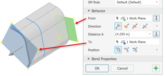

  5. In the Behavior group, specify the following parameters as needed:
    • From. By default, uses the profile sketch plane.
    • Between. Specify a different From and To terminations. Valid inputs are face, point, or work feature.
      Note: When using Between, Direction and Distance are reference values defined by the From and To selections.
    • Direction. Specify the flange direction choosing from:
      • Default direction Default
      • Flipped direction Flipped
      • Symmetric Symmetric
      • AsymmetricAsymmetric
    • Distance A. Specify the length of the contour flange.
    • Distance B. Displays when a second distance value is required. Specify the distance.
    • To face To. Pick a work feature or planar face as the flange termination. Distance is a reference value when To is used.
    • Position. Specify the side of the profile where the flange is created.
      • Default Default uses the profile as an interior edge.
      • Flipped Flipped uses the profile as an exterior edge.
      • Symmetric Symmetric specifies an equidistant offset from the profile.
  6. In the Bend Properties group, you specify the Bend Radius and Unfold Rule to use.
  7. Click OK to end flange creation, or Apply, Create New Apply to continue adding contour flanges.
