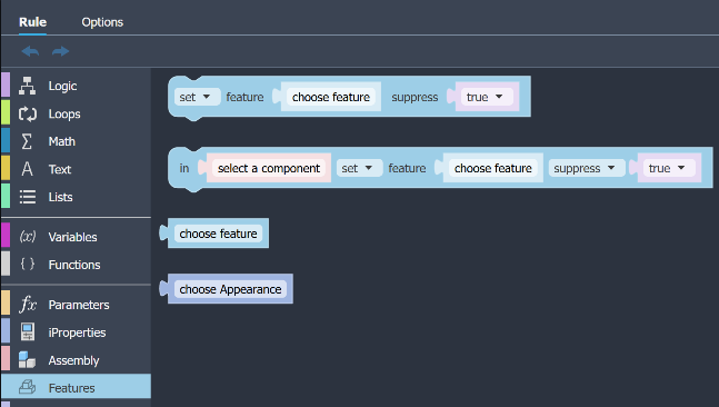

The Feature category provides blocks to get and set feature attributes. For assemblies an additional codeblock is available for getting and setting component attributes.
Get or Set Feature Suppress State
In an assembly, this codeblock gets or sets the suppress state for the selected assembly feature.
In a part, this codeblock gets or sets the suppress state or an appearance for the selected part.
Get or Set Component Feature attribute
Gets or sets feature suppress state or appearance for the specified component in the active assembly.
Choose Feature
Displays the list of Features in the active document. You select the desired material. When used in an assembly rule, the codeblock applies only to assembly features.
Choose Appearance
Displays the list of Appearances in the active document. You select the desired appearance.
