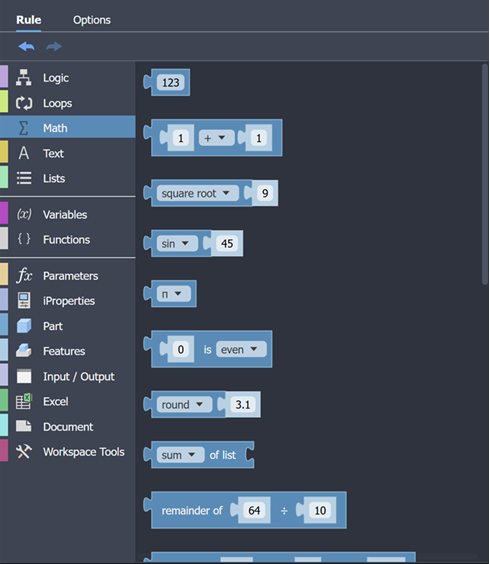

The Math category offers basic arithmetic, trigonometric, and list-based functions, plus iLogic blocks. Use these blocks to perform calculations and evaluate numeric data within your visual program.
Inputs include
Number
The Number codeblock provides an input which holds a decimal value.
The default value is 0. Number is unitless, so you need to include units when they are needed for the output.
Math
The Math codeblock performs a mathematical operation on two numbers.

Function
The Function codeblock performs a mathematical function on an input.

Trigonometry
The Trigonometry codeblock performs trigonometric functions on an input.
Functions include:

Aggregate
The Aggregate codeblock returns a specified value from a list input.
Round
The Round codeblock rounds an input.
Options include:
Remainder
The Remainder codeblock returns the the amount left over when one input is divided by the other. The Remainder codeblock requires two inputs, a divisor and a dividend.
