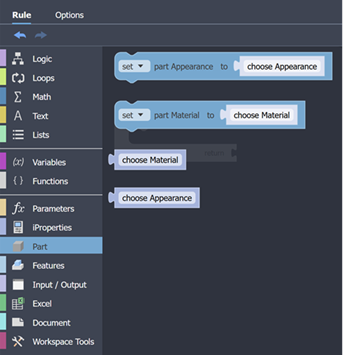

The Part category provides blocks to get and set Inventor part appearance and material.
Get or Set Part Appearance
Provides the means to Get or Set an appearance in the active document.
Get or Set Material
Provides the means to Get or Set a material in the active document.
Choose Material
Displays the list of Materials in the active document. You select the desired material.
Choose Appearance
Displays the list of Appearances in the active document. You select the desired appearance.
