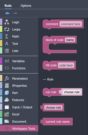

The Workspace Tools category provides codeblocks to do various things in the current rule.
Comment
The Comment codeblock enables placing a comment to explain what the blocks are doing at that point in the code.
Block Group
Provides the means to group blocks together to provide code organization.
VB Code
Provides VB code that is added directly to the generated rule text.
Run Rule
This codeblock runs a specified rule within the current active rule.
Choose Rule
Provides the means to select a rule.
Get Current Rule
Provides the means to get the name of the current rule.
