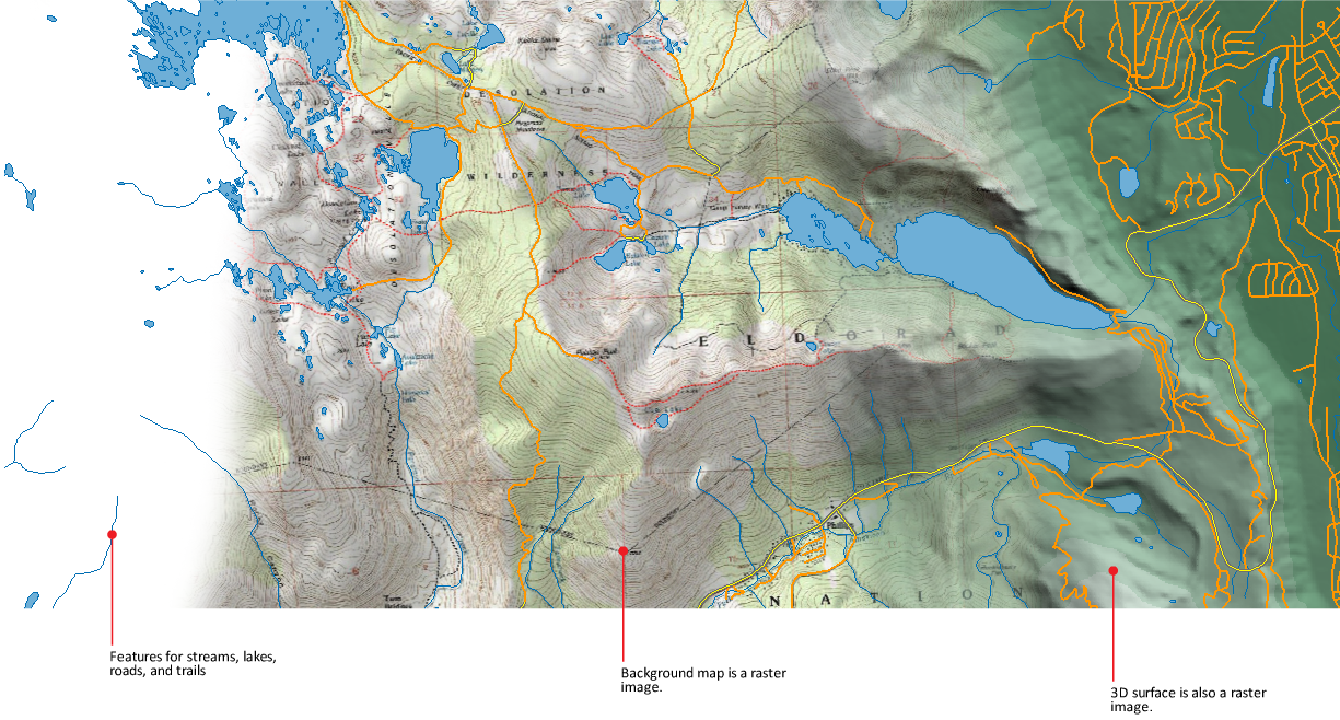

About Raster Images and Surfaces
When creating a map, you can add raster images and surfaces to the display.
Adding one or more images in the background of your map adds context and gives the map visual appeal.

Note: Layers in the map are rendered based on the draw order of the layers in Display Manager. To display drawing objects in front of the raster image, put the raster image layer at the bottom of the list.
