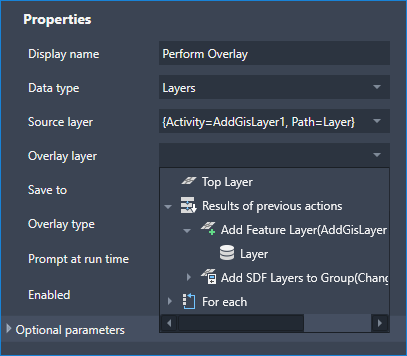

  6. To bind an activity to the output of a previous activity from the input editor, do the following:
    • In the activity input dialog box for the activity, click the down arrow next to the parameter to bind.
    • Under Results Of Previous Actions, click the property to bind to.
      To use a layer created by a previous activity, select it from the list under Results Of Previous Actions.
    Note: There is a shortcut for adding an activity and automatically binding it to the previous activity. Right-click an activity and click the activity to add. For example, right-click an Overlay activity and click Add Feature Layer to create a new Display Manager layer that stores the output of the Overlay operation.
