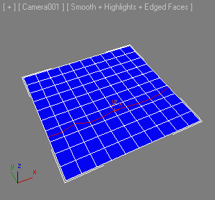

EXAMPLE
Random Connecting Within a 10x10 Grid using autoLoop passed as false:
   --Step 1:
   p = plane lengthsegs:10 widthsegs:10 wirecolor:blue --create a plane
   convertTo p Editable_Poly --convert the plane to Editable_Poly
   select p --select the plane to be able to see the results
   max modify mode --switch Command Panel to Modify mode
   subObjectLevel =2 --switch to polygon sub-object level
   polyOp.setEdgeSelection p #{80,82,84,86,88} --select edges to define a ring
   --Step 2:
   PolyToolsModeling.RandomConnect 0.5 false --connect selected only
In this case, our initial selection already contains enough edges in a ring to create a valid random connection. We do not want the selected edge ring to be expanded further, so we pass false as the second argument, producing a random connection only within the existing selection.

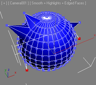

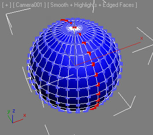

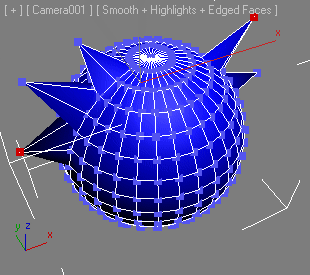

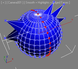

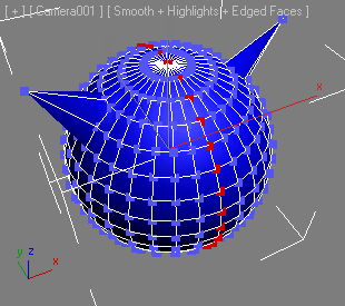

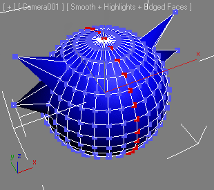

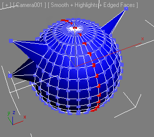

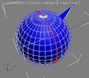

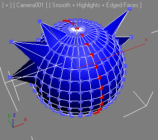

EXAMPLES
Using the Symmetry methods:
   --Step 1:
   s = sphere radius:12 segs:32 wirecolor:blue
   convertTo s Editable_Poly
   select s
   max modify mode
   subObjectLevel = 1
   PolyToolsModeling.SymmetryGather s #x 0.01
   --Step 2:
   PolyOp.moveVert s #{122} [5,0,5]
   --Step 3:
   PolyToolsModeling.SymmetryPosToNeg #x
   --Step 4:
   PolyOp.moveVert s # {170} [-5,0,0]
   --Step 5:
   PolyToolsModeling.SymmetryNegToPos #x
   --Step 6:
   PolyOp.moveVert s #{58} [3,0,5]
   --Step 7:
   PolyToolsModeling.SymmetryFlip #x
   --Step 8:
   PolyOp.setVertSelection s #{122,170}
   PolyToolsModeling.SymmetryCopy()
   PolyOp.moveVert s #{122,170} [5,0,-20]
   --Step 9:
   PolyToolsModeling.SymmetryPaste()

EXAMPLE
Rotating a Polygon Selection at 30 degrees CCW:
   --Step 1:
   max modify mode --switchCommand PaneltoModify mode
   subObjectLevel = 4 --switch topolygonsub-object level
   polyOp.setFaceSelection p #{22,23} --select two polygons to define the loops
   --Step 2:
   PolyToolsModeling.RotateSelection 30 1 -(viewport.getTM()).row3
