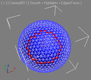

<boolean>PolyToolsSelect.Loop <boolean>cylinderEnds
Selects a loop based on the current sub-object selection:
Sub-Object Level ShiftPressed = False ShiftPressed = True
Polygon Select sets of neighboring polygons and apply to select loops.
Edge Select edges and apply to select loops. The tool can also perform loops on the top and bottom edges of a cylinder. Specifically designed for this purpose.
Vertex Select sets of neighboring vertices and apply to select loops. The tool can also perform loops on the top and bottom vertices of a cylinder. Specifically designed for this purpose.

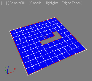

<boolean>PolyToolsSelect.FillHole ()
Fills an enclosed area. Select one sub-object element within the hole and fill. The selected part must stand free from the surrounding selection, so as an example the selected polygon cannot have any selected polygons right next to it.
Sub-Object Level Function
Polygon Select one polygon within the hole and fill.
Edge Select one edge within the hole and fill.
Vertex Select one vertex within the hole and fill.

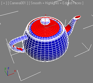

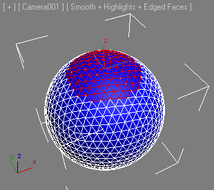

<boolean>PolyToolsSelect.Tops <boolean>withinSel
Selects the tops of extruded parts in the model.
Polygon Apply to select the tops of extruded polygons. Select the tops of extruded polygons only within the current selection.
Edge Apply to select the edge outline of the tops of extruded polygons. Select the edge outline of the tops of extruded polygons only within the current selection.
Vertex Apply to select the vertices of the tops of extruded polygons. Select the vertices of the tops of extruded polygons only within the current selection.

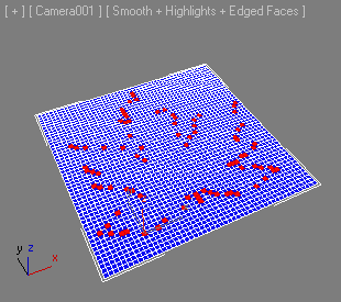

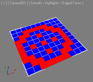

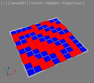

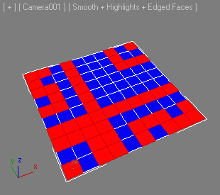

Selection - By Random

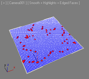

<boolean>PolyToolsSelect.Random <float>percent <integer>number <integer>type <boolean>withinSel
Selects random sub-object elements by percentage or absolute count.
The first argument is the percentage in the range of 0.0 to 100.0. It is used only when the third argument is set to 1.
The second argument is the absolute sub-object count to select. It is used only when the third argument is set to 0.
The third argument determines the selection mode: 0 = use absolute count and 1 = use percentage.
The fourth argument determines whether to select within all sub-objects or only the selected ones:
Polygon Select random polygons. Select random polygons only within the current selection.
Edge Select random edges. Select random edges only within the current selection.
Vertex Select random vertices. Select random vertices only within the current selection.
EXAMPLE
   thePlane = Plane widthsegs:20 lengthsegs:20 --create a plane
   convertTo thePlane Editable_Poly --convert to EPoly
   select thePlane --select the plane
   max modify mode --switch to modify panel
   subObjectLevel = 4 --switch to Polygon level
   PolyToolsSelect.Random 0.0 20 0 false --select 20 randompolygons
   subObjectLevel = 2 --switch toEdgelevel
   PolyToolsSelect.Random 50.0 0 1 false --select50% of the edges

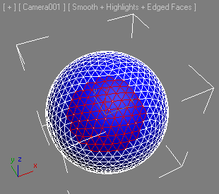

<boolean>PolyToolsSelect.RandomGrow ()
Grows the selection by selecting random sub-object elements outside the border of the selection area.
Returns true on success, false on failure.
<boolean>PolyToolsSelect.RandomShrink ()
Shrinks the selection by deselecting random sub-object elements on the border of the selection.

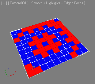

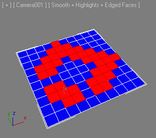

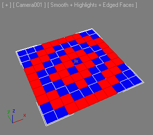

<boolean>PolyToolsSelect.Even <integer>skip <boolean>withinSel
Selects every Nth sub-object element, starting with the second and skipping the number of sub-objects specified by the first argument.
If the second argument is false, all sub-objects will be considered for selection.
If the second argument is true, only already selected sub-objects will be considered.
<boolean>PolyToolsSelect.Odd <integer>skip <boolean>withinSel
Selects every Nth sub-object element, starting with the first and skipping the number of sub-objects specified by the first argument.
If the second argument is true, only the selected sub-objects will be considered.

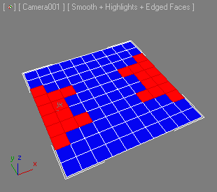

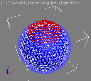

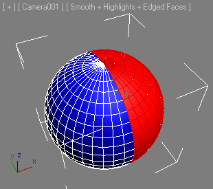

Selection - By Symmetry

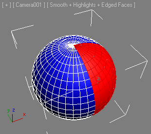

<boolean>PolyToolsSelect.Symmetry <integer>axis
Selects subobject elements in the mirror axis of a symmetrical model.
The argument defines the axis as follows:
0 - X
1 - Y
2 - Z
The center of the object is determined by the object's pivot point.
Polygon Select polygons on one side of the model and apply to select polygons on the symmetrical side in the chosen axis.
Edge Select edges on one side of the model and apply to select edges on the symmetrical side in the chosen axis.
Vertex Select vertices on one side of the model and apply to select vertices on the symmetrical side in the chosen axis.

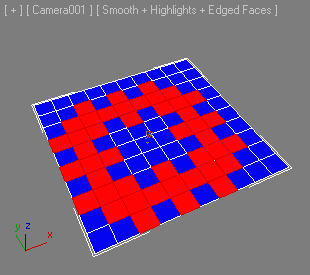

EXAMPLE
   --Step 1:
   p = Plane widthsegs:10 lengthsegs:10 wirecolor:blue --create a plane
   convertTo p Editable_Poly --convert to EPoly
   select p --select the plane
   subObjectLevel = 4 --switch to Face level
   PolyOp.SetFaceSelection p #{38..40, 49, 50, 59, 60, 70, 80} --select some
   --Step2:
   PolyToolsSelect.Symmetry 0 --select symmetrical along X
   --Step3:
   PolyToolsSelect.Symmetry 1 --select symmetrical along Y

<boolean>PolyToolsSelect.NumericEdge <boolean>withinSel
Selects edges that have only one adjacent polygon ("open edges").
The first argument controls whether only edges within the current edge selection must be tested (true) or whether all edges in the object must be used (false).
EXAMPLE
   PolyOp.deleteFaces p #{45..48,58} --delete some faces to add open edges
   PolyToolsSelect.NumericEdge false --select open edges

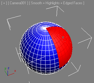

Selection - By Half
<boolean>PolyToolsSelect.Half <integer>axis <boolean>invert <boolean>withinSel
Selects half of the sub-object elements at the current Sub-Object Level.
The first argument specifies the axis as follows:
1 - X
2 - Y
3 - Z
The second argument controls whether the positive side of the object (true) or the negative side of the object (false) will be selected.
The third argument controls whether to use the whole object (false) or only the current selection (true).

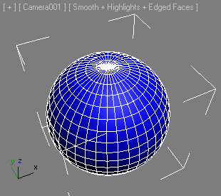

EXAMPLE
   --Step 1:
   s = sphere radius:12 segs:40 wirecolor:blue
   convertTo s Editable_Poly --convert to EPoly
   select s --select the sphere
   subObjectLevel = 4 --switch to facelevel
   --Step 2: Select positive (right) side along X using all faces
   PolyToolsSelect.Half 1 true false
   --Step 3: Select negative (front) side along Y using the existing selection
   PolyToolsSelect.Half 2 false true
   --Step 4:Select positive (top) side along Z using the existing selection
   PolyToolsSelect.Half 3 true true

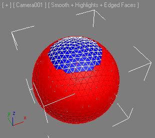

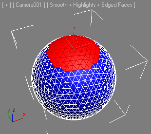

Selection - By Normal
<boolean>PolyToolsSelect.Normal <integer>axis <float>value <boolean>invert
Selects sub-object elements in the current Sub-Object Level based on normal vector.
The first argument defines the reference world axis as follows:
1 - World X
2 - World Y
3 - World Z
The second argument defines the angle threshold. Sub-objects with normals that define an angle with the reference world axis that is less than the threshold will be selected.
The third argument defines whether to select the sub-objects whose normals are below the threshold (false) or the ones whose normals are above the threshold (true).
EXAMPLE
   --Step 1:
   s = geosphere radius:12 segs:10 wirecolor:blue pos:[0,0,-5]
   select s--select the geosphere
   subObjectLevel = 1 --switch to Vertex level
   PolyToolsSelect.Normal 3 15 false --select vertices within 15 degrees to +Z
   --Step2:
   subObjectLevel = 2 --switch to Edge level
   PolyToolsSelect.Normal 3 15 false --selectedgeswithin 15 degrees to +Z
   --Step3:
   PolyToolsSelect.Normal 3 15 false --select faces within 15 degrees to +Z
   --Step4:
   PolyToolsSelect.Normal 3 15 true --selectfaces outside of15 degrees to +Z

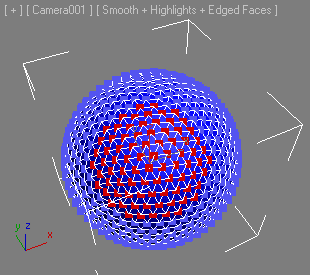

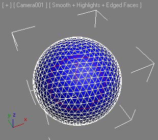

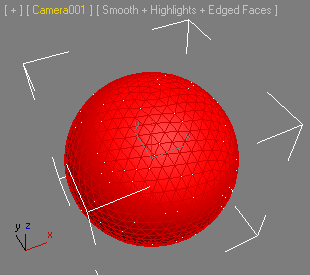

Selection - By Perspective
<boolean>PolyToolsSelect.Perspective <float>value <boolean>outline
Selects sub-object elements at the current Sub-Object Level whose normals are within the given threshold to the current view's Z axis.
The first argument defines the angle threshold.
The second argument controls whether all sub-objects within the Threshold must be selected (false) or only the ones adjacent to the outline of the selection (true).
EXAMPLE
   --Step 1:
   select s --select the geosphere
   PolyToolsSelect.Perspective 30 false
   --Step 2:
   PolyToolsSelect.Perspective 30 true
   --Step 3:
   --Step 4:
   --Step 5:
   --Step 6:

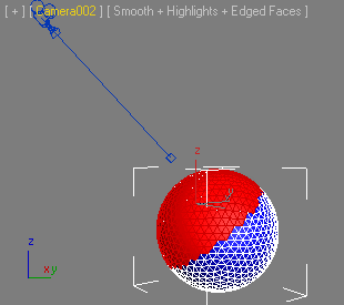

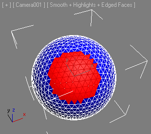

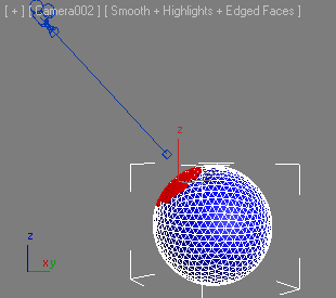

Selection - Grow From Perspective View
<boolean>PolyToolsSelect.PerspectiveGrow <float>value
Grows the sub-selection in the current view space by assuming the closest sub-object element to the viewer's position as 0 and growing the selection away from the viewer in world units.
EXAMPLE
   --Step 1:
   PolyToolsSelect.PerspectiveGrow 2
   --Step 2:
   PolyToolsSelect.PerspectiveGrow 12
Because the Radius of the Geosphere is 12 units, selecting with a value of 12 selects approximately half of the sphere in the current view (Camera001 - left image).

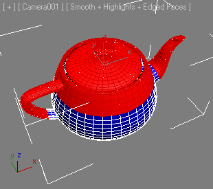

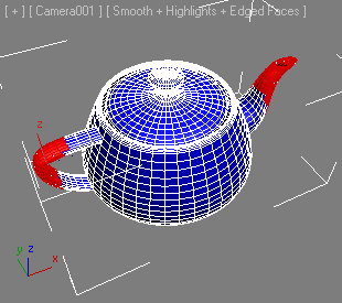

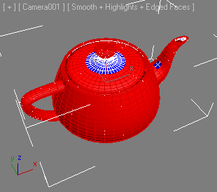

Selection - By Pivot Distance
<boolean>PolyToolsSelect.Distance <float>value
Selects sub-objects in the current level based on a percentage of the largest distance to the pivot point of the object.
The percentage is provided by the first argument.
Returns true on success, false on failure. For example, if not in a valid sub-object mode.
EXAMPLE
   --Step 1:
   t = teapot radius:10 segs:10 wirecolor:blue
   convertTo t Editable_Poly --convert to EPoly
   select t --select the teapot
   PolyToolsSelect.Distance 70.0 --and select using 70%
   --Step2:
   PolyToolsSelect.Distance 60.0 -- select using60%
   --Step 3:
   s.pivot = [0,0,5] --move pivot up by half the radius
   resetxform s --reset XForm
   collapseStack s --and collapse the stack
   subObjectLevel = 4 --switch toFacelevel
   PolyToolsSelect.Distance 70.0 --and select again using 70%
   --Step 4:

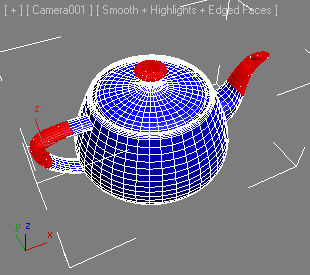

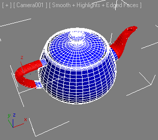

Selection - By Surface
<boolean>PolyToolsSelect.ConvexConcave <float>value <integer>isConcave
Selects sub-objects in the current Sub-Object Level based on a convexity/concavity threshold.
The first argument is the threshold value.
The second argument is the index of the Concave/Convex flyout in the UI as follows:
1 - Concave
2 - Convex
EXAMPLE
   --Step 1:
   select t --select theteapot
   subObjectLevel = 4 --switch to Facelevel
   PolyToolsSelect.ConvexConcave 0.05 1 --Select Concave Faces
   --Step 2:
   PolyToolsSelect.ConvexConcave 0.001 2 --Select Convex Faces

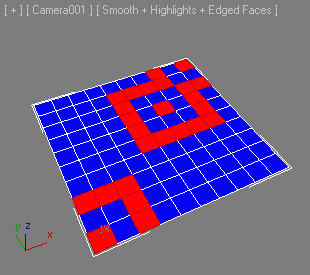

Selection - Patterns
<boolean>PolyToolsSelect.Pattern1 <integer>times
Applies Selection Pattern 1 for the specified number of times.
EXAMPLE
   --Step 1:
   PolyOp.SetFaceSelection p #{45} --select a central face
   --Step 2:
   PolyToolsSelect.Pattern1 1
   --Step 3:
   --Step 4:
   --Step 5:
   --Step 6:
Note that you can achieve the look seen on the above right screenshot by calling
   PolyToolsSelect.Pattern1 5
right after evaluating Step 1 to perform the iterations internally.

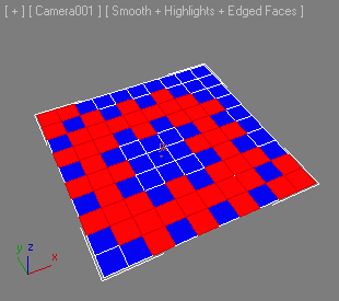

<boolean>PolyToolsSelect.Pattern2 <integer>times
Applies Selection Pattern 2 for the specified number of times.
EXAMPLE
   --Step 1:
   --Step 2:
   PolyToolsSelect.Pattern2 1
   --Step 3:
   --Step 4:
   --Step 5:
   --Step 6:

<boolean>PolyToolsSelect.Pattern4 <integer>times
Applies Selection Pattern 4 for the specified number of times.
EXAMPLE
   --Step 1:
   --Step 2:
   PolyToolsSelect.Pattern4 1
   --Step 3:
   --Step 4:
   --Step 5:
   --Step 6:

   --Step 1:
   --Step 2:
   PolyToolsSelect.Pattern6 1
   --Step 3:
   --Step 4:
   --Step 5:
   --Step 6:
   --Step 7:
   --Step 8:

   --Step 2:
   PolyToolsSelect.Pattern7 1
   --Step 3:
   --Step 4:
   --Step 5:
   --Step 6:
   --Step 7:
   --Step 8:

<boolean>PolyToolsSelect.PatternDots <integer>times
Applies Selection Pattern Dots for the specified number of times.
EXAMPLE
   --Step 1:
   --Step 2:
   PolyToolsSelect.PatternDots 1
   --Step 3:
   --Step 4:
   --Step 5:
   --Step 6:
<boolean>PolyToolsSelect.PatternChecker <integer>times
Applies Selection Pattern Checker for the specified number of times.
EXAMPLE
   --Step 1:
   --Step 2:
   PolyToolsSelect.PatternChecker 1
   --Step 3:
   --Step 4:
   --Step 5:
   --Step 6:

<boolean>PolyToolsSelect.PatternOneRing <integer>times
Applies Selection Pattern One Ring for the specified number of times.
EXAMPLE
   --Step 1:
   --Step 2:
   PolyToolsSelect.PatternOneRing 1
   --Step 3:
   --Step 4:
   --Step 5:
   --Step 6:

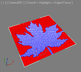

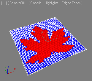

Selection - By Bitmap
<boolean>PolyToolsSelect.BitmapToSel <string>file <integer>mapchannel <point3>color
Selects sub-objects in the current Sub-Object Level based on a color from a bitmap file using a given mapping channel for the bitmap application.
The first argument is the file name of the bitmap.
The second argument is the mapping channel to use for the mapping of the bitmap onto the geometry.
The third argument is the color from the bitmap to use for selecting.
Internally, the color will be compared with a built-in threshold of +/- 8.0 (256/8= 32, so the threshold is 1/32 or about 3%).
EXAMPLE
   --Step 1:
   p = Plane widthsegs:50 lengthsegs:50 wirecolor:blue --create a plane
   subObjectLevel = 4 --switch to Edge level
   --Select faces where the bitmap color is pure white.
   PolyToolsSelect.BitmapToSel "ELMLEAF.TGA" 1 white
   --Step 2: Select faces where color is black.
   PolyToolsSelect.BitmapToSel "ELMLEAF.TGA" 1 black
   --Step 3:
   PolyToolsSelect.BitmapToSel "ELMLEAF.TGA" 1 (white*0.97)
   --Step 4:
   PolyToolsSelect.BitmapToSel "ELMLEAF.TGA" 1 (white*0.96)
   --Step 3:
   PolyToolsSelect.BitmapToSel "ELMLEAF.TGA" 1 (white*0.04)
   --Step 4:
   PolyToolsSelect.BitmapToSel "ELMLEAF.TGA" 1 (white*0.03)
