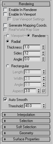

Rendering Rollout
Properties
<SplineShape>.render_renderable BooleanClass default: false -- boolean; renderable
Toggles the "Enable in Renderer" checkbox on and off.
Available in 3ds Max 8 and higher.
<SplineShape>.render_displayRenderMesh BooleanClass default: false -- boolean; displayRenderMesh
Toggles the "Enable In Viewport" checkbox on and off. When set to true, the mesh will be displayed in the viewports.
<SplineShape>.render_useViewportSettings BooleanClass default: false -- boolean; useViewportSettings
Toggles the "Use Viewport Settings" checkbox on and off.
When set to true, the mesh displayed in the viewport will use the Viewport settings.
When false, the Renderer settings will be used for the viewport mesh.
<SplineShape>.render_mapcoords BooleanClass default: false -- boolean; mapcoords
Toggles mapping coordinates generation on and off.
The U coordinate wraps once around the thickness of the spline; the V coordinate is mapped once along the length of the spline.
<SplineShape>.realWorldMapSize BooleanClass default: false -- boolean
Toggles the real-world map size option on and off.
<SplineShape>.render_displayRenderSettings BooleanClass default: true -- boolean; displayRenderSettings
Toggles the state of the Viewport/Renderer radio buttons.
When set to true, the Renderer settings will be displayed in the rollout.
When false, the Viewport settings will be shown instead.
<SplineShape>.render_rectangular BooleanClass default: false -- boolean
When set to true, enables the Rectangular cross-section mode to be used in the renderer.
When false (default), enables the Radial cross-section mode.
Corresponds to the Radial/Rectangular radio buttons in the UI in the Renderer mode.
<SplineShape>.render_viewport_rectangular BooleanClass default: false -- boolean
When set to true, enables the Rectangular cross-section mode to be used in the viewports.
Corresponds to the Radial/Rectangular radio buttons in the UI in the Viewport mode.
Renderer - Radial Cross-Section
Properties
<SplineShape>.render_thickness Float default: 1.0 -- animatable; thickness
Gets/Sets the diameter of the Radial renderable spline mesh.
<SplineShape>.render_sides Integer default: 12 -- animatable; sides
Gets/Sets the number of sides for the spline mesh in the renderer.
For example, a value of four will give you a square cross section.
<SplineShape>.render_angle Float default: 0.0 -- animatable; angle
Gets/Sets the rotational position of the Radial cross-section in the renderer.
Renderer - Rectangular Cross-Section
Properties
<SplineShape>.render_length Float default: 6.0 -- animatable
Gets/Sets the length of the Rectangular renderable spline mesh.
<SplineShape>.render_width Float default: 2.0 -- animatable
Gets/Sets the width of the Rectangular renderable spline mesh.
<SplineShape>.render_angle2 Float default: 0.0 -- animatable
Gets/Sets rotational position of the Radial cross-section in the renderer.
<SplineShape>.render_aspect_locked BooleanClass default: false -- boolean
Controls the state of the Aspect Lock checkbutton.
When set to true, changing the Width will affect the Height and vice-versa, preserving the aspect at the time the lock was engaged.
Viewport - Radial Cross-Section
Properties
<SplineShape>.render_viewport_thickness Float default: 1.0 -- float; viewport_thickness
Gets/Sets the diameter of the Radial renderable spline mesh in the viewport.
<SplineShape>.render_viewport_sides Integer default: 12 -- integer; viewport_sides
Gets/Sets the number of sides for the Radial spline mesh in the viewports.
<SplineShape>.render_viewport_angle Float default: 0.0 -- float; viewport_angle
Gets/Sets the rotational position of the cross-section in the viewports.
Viewport - Rectangular Cross-Section
Properties
<SplineShape>.render_viewport_length Float default: 6.0 -- float
Gets/Sets the length of the Rectangular spline mesh in the viewports.
<SplineShape>.render_viewport_width Float default: 2.0 -- float
Gets/Sets the width of the Rectangular spline mesh in the viewports.
<SplineShape>.render_viewport_angle2 Float default: 0.0 -- float
Gets/Sets the rotational position of the Rectangular cross-section in the viewports.
<SplineShape>.render_viewport_aspect_locked BooleanClass default: false -- boolean
Auto Smooth
Properties
<SplineShape>.render_auto_smooth BooleanClass default: true -- boolean
Controls the state of the Auto Smooth checkbox.
When set to true, auto smoothing will be enabled.
<SplineShape>.render_threshold Float default: 40.0 -- animatable;
Gets/sets the Auto Smooth Threshold value. Available in 3ds Max 8 and higher.

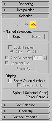

Selection Rollout
No Related Properties or Method exposed to MAXScript.

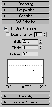

Soft Selection Rollout

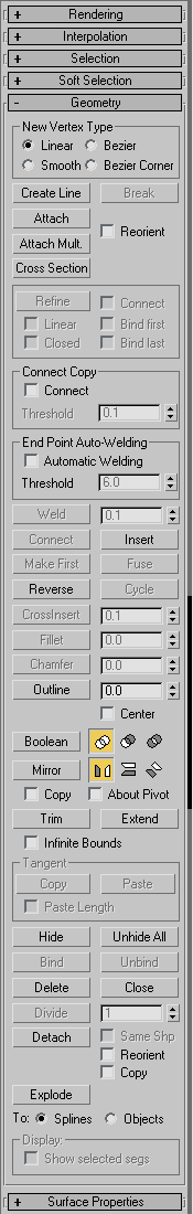

Geometry Rollout
Create, Break, Attach
Methods
splineOps.startCreateLine <editable_spline_or_line_node_or_modifier>
Enters the "Create Line" command mode. It is valid in all Sub-Object levels and when not in the Sub-Object mode.
See Editable Spline Modify Panel Command Modes and Operations for the full list of UI-related methods.
splineOps.startBreak <editable_spline_or_line_node_or_modifier>
Enters the "Break" command mode. It is valid in Vertex and Segment Sub-Object levels.
splineOps.startAttach <editable_spline_or_line_node_or_modifier>
Enters the "Attach" command mode. It is valid in all Sub-Object levels and when not in the Sub-Object mode.
splineOps.attachMultiple <editable_spline_or_line_node_or_modifier>
Displays the Attach Multiple dialog allowing the user to select multiple shapes to attach. Valid in all Sub-Object levels and when not in the Sub-Object mode.
Refine
Methods
splineOps.startRefine <editable_spline_or_line_node_or_modifier>
Enters the "Refine" command mode. It is valid in Vertex and Segment Sub-Object levels. This method does not turn off the Connect checkbox, so it is effectively the same as the startRefineConnect() method.
splineOps.startRefineConnect <editable_spline_or_line_node_or_modifier>
Enters the "Refine" command mode. It is valid in Vertex and Segment Sub-Object levels. This method does not turn on the Connect checkbox, so it is effectively the same as the startRefine() method.
Weld, Connect, Insert, Make First, Fuse, Reverse, Cycle
Methods
splineOps.weld <editable_spline_or_line_node_or_modifier>
Welds the selected vertices. It is valid in the Vertex Sub-Object level.
See also the related methods in ShapeMethods-Weld.
splineOps.startConnect <editable_spline_or_line_node_or_modifier>
Enters the "Connect" command mode. It is valid in the Vertex Sub-Object level.
splineOps.startInsert <editable_spline_or_line_node_or_modifier>
Enters the "Insert" command mode. It is valid in all Sub-Object levels, and when not in the Sub-Object mode.
splineOps.makeFirst <editable_spline_or_line_node_or_modifier>
Makes the selected vertices the first vertex in the spline. It is valid in the Vertex Sub-Object level.
splineOps.fuse <editable_spline_or_line_node_or_modifier>
Fuses the selected vertices. Valid in the Vertex Sub-Object level.
splineOps.reverse <editable_spline_or_line_node_or_modifier>
Reverses the order of vertices in the selected splines. It is valid in the Spline Sub-Object level.
splineOps.cycle <editable_spline_or_line_node_or_modifier>
Cycles through the vertices of the spline, selecting each vertex.
At least one vertex must be selected before calling this method, or no vertex is selected.
If more than one vertex is selected when this method is called, the first vertex of the first shape is selected.

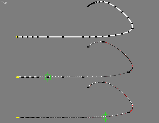

getSegLengths <splineShape> <spline_index> [cum:<boolean>] \
[byVertex:<boolean>] [numArcSteps:<integer>]
Returns an array of segment lengths or vertex distances by spline fraction and length, and total spline length.
Double precision calculations are very accurate.
If cum:true, the results are cumulative, otherwise they are relative.
If byVertex:true, the results are per vertex, otherwise per segment.
Defaults: cum:false byVertex:false numArcSteps:100

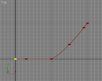

subdivideSegment <splineShape> <spline_index> <seg_index> <divisions>
Divides the segment into the specified number of divisions.

VERTEX AND LENGTH INTERPOLATION METHODS:
There are two methods to interpolate a position along the spline: vertex interpolation and length interpolation.
When using vertex interpolation (path interpolation), the spline is seen as a number of segments where each segment between two vertices is a normalized space from 0.0 to 1.0. The distance between the two vertices of a segment is ignored during the interpolation, which means that if the lengths of the segments are different, interpolating linearly along the spline will result in varying speed.
You can visualize this on a Path Constraint with Constant Velocity unchecked where the object is moving faster between two vertices when the segment between them is longer (see the image below).
When using length interpolation, the whole spline length is normalized, so a parameter of 0.5 will be exactly in the middle of the spline regardless of the segments' lengths. The speed of a point interpolated along the spline using a parameter that changes linearly between 0.0 and 1.0 will remain constant along the whole spline even if the vertex placement is irregular.
This can be demonstrated when checking the Constant Velocity checkbox in the Path Constraint that enables the length interpolation:
In this image, the top object is a SplineShape with varying segment length and ten segments.
The middle object is a copy of the same shape used as a path by a Point Helper. The Constant Velocity checkbox was unchecked in the Path Constraint causing it to use vertex interpolation. For 100 frames, it divided the shape in ten segments and placed ten samples on each segment resulting in varying speed dependent on the length of the segment.
The bottom object is a copy of the same shape used as a path by another Point Helper, but this time Constant Velocity is turned on causing it to use length interpolation. You can see clearly that the samples are evenly spaces along the full length of the shape disregarding the distances between the vertices defining the segments.
The time slider was set of frame 50. The length interpolation at the bottom places the point helper exactly at the middle of the path shape, while the vertex interpolation places it exactly on the vertex between the 5 th and the 6 th segment.

The vertex interpolation at the right side hits more or less precisely the start or end vertex and the center of each of the 10 segments because we are stepping with 1/20 th per iteration, while the length interpolation takes into account the actual length of all segments and moves smoothly along the spline.

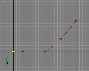

refineSegment <shape> <spline_index_integer> <seg_index_integer> <seg_interp_param_float>
Adds a new knot to the indexed segment of the indexed curve at a place along the indexed segment corresponding to the given segment interpolation parameter.
This value is a float in the range of 0.0 to 1.0 specifying a proportion along the segment.
The new knot coordinates, and in-vector and out-vector are automatically computed to maintain the segment's existing curvature.
This is the primitive used by the refine() function in the Edit Spline modifier.
You can use the MAXScript spline path interpolation functions to derive segment parameters given that a curve's path interpolation parameter is divided evenly among the segments in a curve.
Given a path interpolation parameter u in a spline of m segments, the target segment is:
n = (m*u) as integer + 1
The segment parameter is:
f = (u-(n-1)/m)*m
This can be refactored to the following which will reduce roundoff error in the calculation:
f = u*m-n+1
The refineSegment() function returns the index of the newly inserted knot.
EXAMPLE

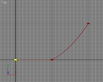

s = splineShape() --create a spline shape
addNewSpline s --add a spline to it
addKnot s 1 #corner #line [0,0,0] --add a knot at origin
addKnot s 1 #smooth #curve [100,0,0] --add a knot @100 units along X
addKnot s 1 #corner #line [200,100,0] --add a third knot
updateShape s --update the shape
s.vertexTicks = true --enable vertex ticks

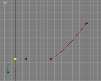

--We have two segments and three knots now.
refineSegment s 1 1 0.3 --divide the first segment at 30/70% ratio
updateShape s --update the shape to see the result
--Since our first segment was 100 units long, the vertex is exactly
--at 30 units from the origin, just as expected:
--now we have 3 segments - the original second segment is not third
refineSegment s 1 3 0.5 -- let's divide it in two equal parts
--Because the segment is curved, the knot is not at equal distances
--to the two other knots along a straight line, but the
--distances ALONG THE CURVED SEGMENT are equal:
refineSegment s 1 4 0.8 --divide the new last segment at 80/20% ratio
updateShape s --and update the shape to see the result:
