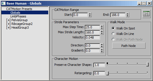

 <CATHierarchyRoot>.PathFacingRatio : float
Get/set the Path facing ratio.
 <CATHierarchyRoot>.CATMotionFlags : integer
Get/set the CATMotion flags value.
 <CATHierarchyRoot>.Retargetting : float
Get/set the retargeting value.
 <CATHierarchyRoot>.ActiveLeaf : integer
Get/set the active leaf index.
 <CATHierarchyRoot>.StartTime : float
Get/set the CATMotion's Start Time value.
 <CATHierarchyRoot>.EndTime float
Get/set the CATMotion's End Time value.
 <CATHierarchyRoot>.MaxStepTime float
Get/set the max. step time value.
 <CATHierarchyRoot>.MaxStepLength float
Get/set the Max Stride Length value.
 <CATHierarchyRoot>.Direction float
Get/set the Direction value.
 <CATHierarchyRoot>.Gradient float
Get/set the Gradient value.
 <CATHierarchyRoot>.WalkMode: integer
Get/set the Walk Mode value.
Possible values are:
0 - Walk On Spot
1 - Walk On Line
2 - Walk On Path Node
 <CATHierarchyRoot>.StepEase float
Get/set the Step Ease value.
 <CATHierarchyRoot>.DistCovered float
Contains the covered distance value.
Use the .updateDistCovered() method exposed by the CATMotion Functions interface to force a refresh of the data.
