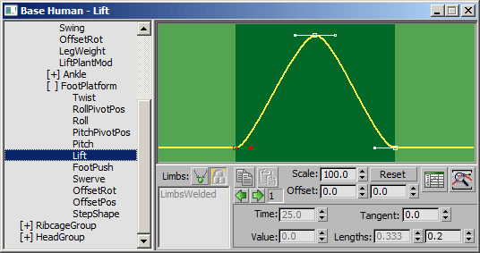

This is a CATMotion Controller used in the animation of feet in 3ds Max CAT.
Constructors
Class instances not creatable by MAXScript
Aliases
CATFootLift FootLift
Properties
 <CATFootLift>.CATBranch : maxObject
Contains the Branch controller.
 <CATFootLift>. LimbData (CATLimbData) : maxObject
Contains the LimbData controller object.
 <CATFootLift>.Amount : float
Get/set the foot lift amount.
Foot Lift Tangent
 <CATFootLift>.LiftTangent : float
Get/set the foot lift tangent value.
 <CATFootLift>.LiftTanLength (LiftTanLen) : float
Get/set the foot lift tangent length value.
Foot Peak Tangent
 <CATFootLift>.PeakTangent : float
Get/set the peak tangent value.
 <CATFootLift>.PeakInTanLength (PeakInTanLen) : float
Get/set the peak in tangent length value.
 <CATFootLift>.PeakOutTanLength (PeakOutTanLen) : float
Get/set the peak out tangent length value.
 <CATFootLift>.PeakTime : float
Get/set the peak time value.
Foot Plant Tangent
 <CATFootLift>.PlantTangent : float
Get/set the plant tangent value.
 <CATFootLift>.PlantTanLength (PlantTanLen) : float
Get/set the plant tangent length value.
