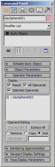

Display
<Body_Object>.ShowResultOP (Show_Result__Hide_Ops) : boolean
Get/set the state of the Result checkbox.
<Body_Object>.ShowAllOperandsOP(Show_Ops__Hide_Result) : Boolean
Get/set the state of the All Operands checkbox.
<Body_Object>.ShowSelectedOperandsOP(Show_Selected_Operands) : boolean
Get/set the state of the Selected Operands checkbox.

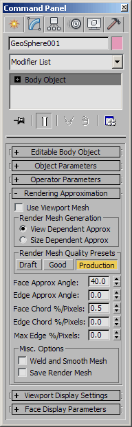

Rendering Approximation
<Body_Object>.RenderViewportMeshRA(Render_Viewport_Mesh) : boolean
Get/set the state of the Use Viewport Mesh checkbox.
Render Mesh Generation
<Body_Object>.RenderRadioRA(Render_Radio) : integer
Get/set the state of the Render Mesh Generation radio buttons.
Possible values are:
0 - View Dependent Approx.
1 - Size Dependent Approx.
Render Mesh Quality Presets
<Body_Object>.LowQualityRA (LowQuality) : boolean
Get/set the state of the Draft checkbutton.
<Body_Object>.MediumQualityRA (MediumQuality) : boolean
Get/set the state of the Good checkbutton.
<Body_Object>.HighQualityRA (HighQuality) : boolean
Get/set the state of the Production checkbutton.
Approximation
<Body_Object>.FaceApproxAngleRA (Face_Angle) : float
Get/set the Face Approx. Angle value.
<Body_Object>.EdgeApproxAngleRA (Edge_Angle) : float
Get/set the Edge Approx. Angle value.
<Body_Object>.FaceChordRA (Face_Chord) : float
Get/set the Face Chors %/Pixels value.
<Body_Object>.EdgeChordRA (Edge_Chord) : float
Get/set the Edge Chord %/Pixels value.
<Body_Object>.MaxEdgeRA (Edge_Length_Rendering) : float
Get/set the Max.Edge %/Pixels value.
Misc. Options
<Body_Object>.WeldAndSmoothRA (Weld_and_Smooth) : boolean
Get/set the state of the Weld And Smooth Mesh checkbox.
<Body_Object>.SaveRenderMeshRA (Save_Render_Mesh) : boolean
Get/set the state of the Save Render Mesh checkbox.

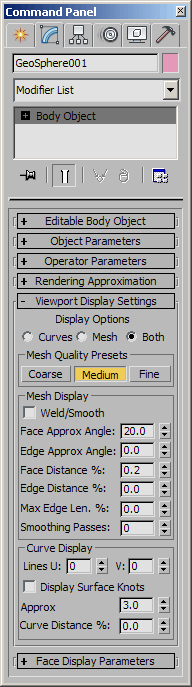

Viewport Display Settings
<Body_Object>.DisplayRadioVDS (Display_Radio) : integer
Get/set the state of the Display Options radio buttons.
0 - Curves
1 - Mesh
2 - Both (default)
<Body_Object>.LowQualityVDS (LowQuality) : boolean
Get/set the state of the Coarse checkbutton.
<Body_Object>.MediumQualityVDS (MediumQuality) : boolean
Get/set the state of the Medium checkbutton.
<Body_Object>.HighQualityVDS (HighQuality) : boolean
Get/set the state of the Fine checkbutton.
Mesh Display
<Body_Object>.CleanMeshVDS (CleanMesh) : boolean
Get/set the state of the Weld/Smooth checkbox.
<Body_Object>.FaceApproxAngleVDS (Face_Approx__Angle) : float
<Body_Object>.EdgeApproxAngleVDS (Edge_Approx__Angle) : float
<Body_Object>.FaceChordHeightVDS (Face_Chord_Height) : float
Get/set the Face Distance % value.
<Body_Object>.EdgeChordHeightVDS (Edge_Chord_Height) : float
Get/set the Edge Distance % value.
<Body_Object>.MaxEdgeLengthPctVDS (Edge_Length) : float
Get/set the Max.Edge Len. % value.
<Body_Object>.SmoothingPassesVDS (Smoothing_Passes) : float
Get/set the Smoothing Passes value.
Curve Display
<Body_Object>.ULinesVDS (U_Lines) : float
Get/set the Lines U value.
<Body_Object>.VLinesVDS (V_Lines) : float
Get/set the Lines V value.
<Body_Object>.DisplaySurfaceKnotsVDS (Display_Surface_Knots) : boolean
Get/set the state of the Display Surface Knots checkbox.
<Body_Object>.IsoAngleDS (Iso_Angle) : float
Get/set the Approx value.
<Body_Object>.IsoChordHeightVDS (Iso_Chord) : float
Get/set the Curve Distance value.

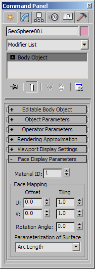

Face Display Parameters
No Properties Exposed.
