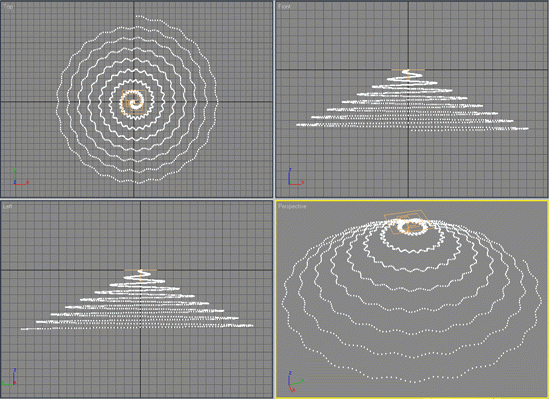

The script generates a nice particle pattern - a helix built by a sine curve. In order to see the effect of the script, you should:

               --Define a radius variable based on the sine of the current time
               sh = 2 * sin(5 * curTime)
               --Define an angle variable based on the current time
               ang = 0.2 * curTime
               --Set the particle position using the above variables
               pCont.particlePosition = [sh * sin(ang), sh * cos(ang), 0]
               --Define the speed using the same variables and falling down along Z
               pCont.particleSpeed = [0.01 * sin(ang), 0.01 * cos(ang), -0.005]
