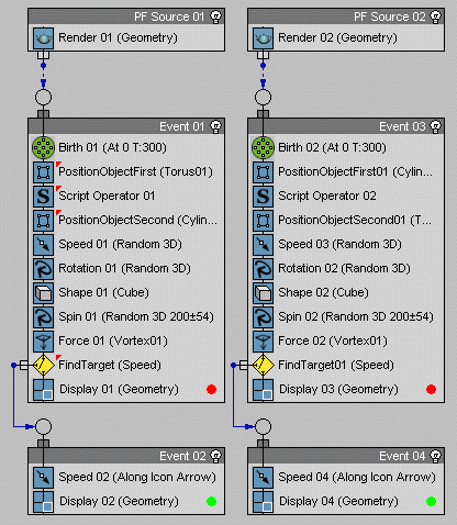

The following sample is based on Laszlo Sebo's VolumeDocking01.max scene and illustrates the following MAXScript operations with Particle Flow :
Can Be Used With:
The script is self-contained and recreates all objects and Particle Flow Events and Actions on the fly:
Effect:
The script creates two geometry primitives and two PF_Sources with corresponding Actions and Events.
The geometry objects are used as volumes to be filled with particles. The initial positions of the particles are dumped to the particleVector channel. Using a Find_Target action, the particles find their way from the one volume to the other and switch places after swirling around.

   -- PF_Flow setup
   pf=PF_Source Show_Logo:off Show_Emitter:off Quantity_Viewport:100 isSelected:true
   -- Action List - Appending Example --
   -- Disable automatic Event Encapsulation & begin editing:
   ParticleFlow.BeginEdit()
   a1 = RenderParticles()--define Action 1
   pf.AppendAction a1--append the Action to PF_Source
   ParticleFlow.EndEdit()--End editing, enable Auto-Encapsulation

   -- Define First Event --
   ParticleFlow.BeginEdit()--start editing
   -- Create a Birth Action for Event 1
   ev1_a1 = Birth Emit_Start:0 Emit_Stop:0 Amount:300
   -- Create a Position Object Action for Event 1
   ev1_a2 = Position_Object Location:4 Emitter_Objects:#(tor) name:"PositionObjectFirst"

   -- Create a new empty event, then append all already created
   -- actions to it:
   ev1 = Event()
   ev1.AppendAction ev1_a1
   ev1.AppendAction ev1_a2
   ev1.AppendAction ev1_a3
   ev1.AppendAction ev1_a4
   ev1.AppendAction ev1_a5
   ev1.AppendAction ev1_a6
   ev1.AppendAction ev1_a7
   ev1.AppendAction ev1_a8
   -- Disable editing, enable Auto-Event-Encapsulation
   -- Append the event as the Initial Action List to the PF_Source.
   -- This will connect the Event to the PF_Source.
   pf.appendInitialActionList ev1
   -- Position the Event inside the Particle View
   ev1.SetPViewLocation x (y+100)

   -- Create a Second Event and its actions:
   ev2_a1 = Speed Speed:0
   ev2 = Event()
   ev2_a2 = DisplayParticles Type:6 Color:(color 0 255 0)
   ev2.AppendAction ev2_a1
   ev2.AppendAction ev2_a2
   --Connect the second Event to the Find_Target
   ev1_a11.setNextActionList ev2 ev1_a11
   --Reposition the even
   ev2.SetPViewLocation x (y+400)
   -- Make copy of PF_Source and exchange Emitter objects
   -- for Position_Object operators:
   -- Clone the PF_Source and the two Emitters,
   -- store the clones in a by-reference variable
   maxOps.CloneNodes #(pf, ev1, ev2) newNodes:&dc
   -- Get the PF_Source and Emitter clones
   pfc = dc[1]
   ev1c = dc[2]
   ev2c = dc[3]
   -- Get the current position of the Particle View...
   x=y=1
   pfc.GetPViewLocation &x &y
   -- Reposition the two Events
   ev1c.SetPViewLocation x (y+100)
   ev2c.SetPViewLocation x (y+400)
