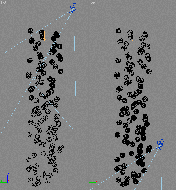

The following example shows a possible way to control the resolution of particles based on the distance to a camera.
Can Be Used With:
Should be used in a Script_Operator.
Effect:
The script uses a Sphere primitive from the scene as the shape of every particle and sets its segments based on the distance to a hard-coded camera $Camera001. As particles get farther from the camera, they get less polygons.

               --At distance of 500.0 units the segments will be set to 2
               --At distance of 250.0 the segments will be 4, at 100 units 10 etc.
               --Change the function to get the desired falloff
               sph.segs = 1000.0/(length (pCont.particlePosition - $Camera01.pos))
