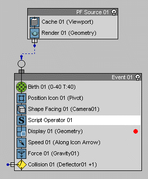

The following example uses a Script Operator to assign a single letter to each particle based on a scene text objects. You can type in any text you want, define the font and change the appearance of the text using modifiers like Extrude and Bevel and let Particle Flow generate a stream of letters showing the text.

The scripts should be used inside a Script_Operator.

You can change the timing of the Birth operator to get more particles if your text is longer than the default
You can use any other PFlow operators to affect the particles. The Script is only responsible for the shape of the particles.
