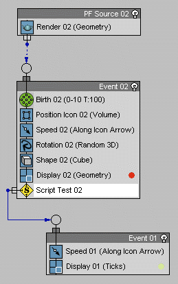

Shows the necessity of using the Integrator. Without the Integrator particles are stopped somewhere around the zero Z plane. The Integrator is able to stop particles exactly at the plane level (without any modification of the particle position).
In the example flow, the particles are born and accelerated. The Script_Test checks their position and if they pass the scripted test, they are moved to the second event which stops them.
