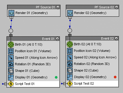

Create a PF_Source in the viewport.
Open Particle View.
Add a Script_Test action to the end of Event01.
Clone the particle system but leave it at the exactly same position.
Change the color of the second particle system
Load the first sample in the Script_Test of the first particle system.
Load the second sample in the Script_Test of the second particle system.
