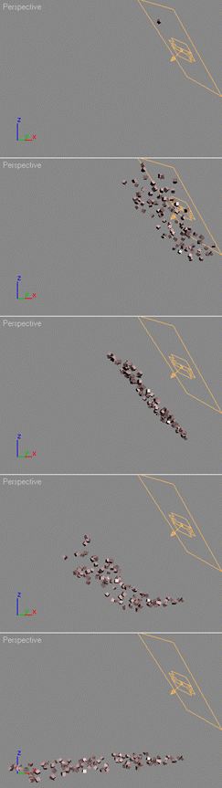

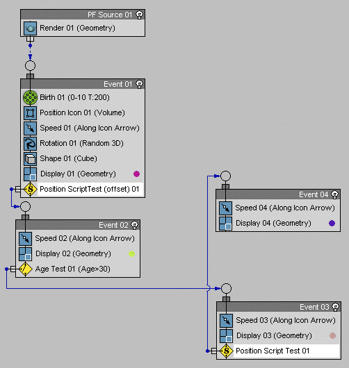

The following example uses Script_Test actions to implement scripted position tests with both relative offset and absolute position options.
Can Be Used With:
The two scripts must be used inside the Script_Test : Helper actions.
Effect:
