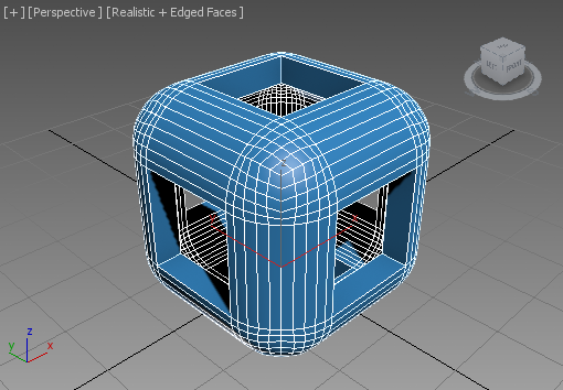

EXAMPLE
   b = box()  --create a default Box
   c = chamfer() --create a Chamfer modifier
   addModifier b c --add the Chamfer to the Box
   c.amount = 5.0 --set the Amount to 5.0
   c.segments = 5 --set the Segments to 5
   c.tension = 0.5 --set the Tension to 0.5 to curve the new faces
   c.openChamfer = true --remove the new faces
   c.Invert = true --invert to remove the old faces instead
   s = shell() --create a Shell modifier
   s.outerAmount = 4.0 --set its Outer Amount (Thickness) to 4.0
   addModifier b s --add the Shell modifier to the Box above the Chamfer modifier
RESULT:

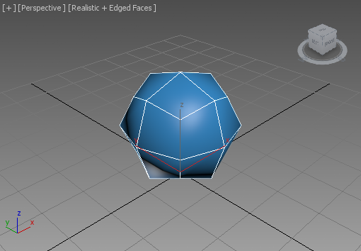

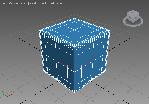

EXAMPLE
   c.amount = 2.0 --set the Amount to 2.0
   c.segments = 2 --set the Segments to 2
   c.tension = 0.0 --set the Tension to 0.0 to add new edges without changing the existing shape
   t = turboSmooth() --create a TurboSmooth modifier
   addModifier b t --add the TurboSmooth modifier to the Box
   --Try turning off the Chamfer modifier to see the difference (second image)...
RESULTS:
