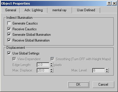

mental ray Indirect Illumination Properties
<node>.generatecaustics Boolean default: false
Get or set whether the node generates caustics. Caustics are not supported by the 3ds Max scanline renderer.
<node>.rcvcaustics Boolean default: true
Get or set whether the node receives caustics. Caustics are not supported by the 3ds Max scanline renderer.
<node>.generateGlobalIllum Boolean default: false
Get or set whether the node generates global illumination. Global illumination is not supported by the 3ds Max scanline renderer.
<node>.rcvGlobalIllum Boolean default: true
Get or set whether the node receives global illumination. Global illumination is not supported by the 3ds Max scanline renderer.
