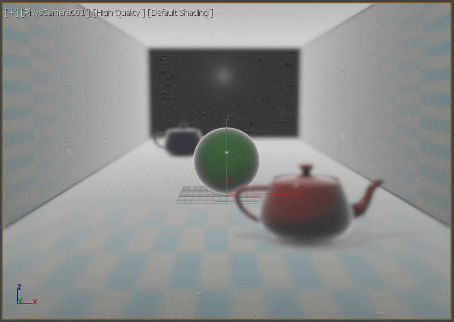

DOF BOX EXAMPLE:
-- Reset Max File
resetmaxfile #noprompt
-- Set the viewport Matrix
viewport.setTM (matrix3 [1,0,0] [0,0,-1] [0,1,0] [6,-150,-800])
-- Create a box
bx = box width:500 height:300 length:2000 backfacecull:true mapcoords:on
addModifier bx (normalModifier flip:true)
-- Create a checker map with tiling in U and V at 10
mp1 = checker color1:[0,200,255] color2:[255,255,200]
mp1.coords.U_Tiling = 10
mp1.coords.V_Tiling = 10
-- Assign a physical material to the box
bx.material = PhysicalMaterial base_color_map:mp1
-- Create and assign to the scene a Physical_Camera_Exposure_Control
SceneExposureControl.exposureControl = Physical_Camera_Exposure_Control()
-- Create a photometric Freelight
om = Free_Light pos:[0,-300,250] global_ev:6
-- Create a Sphere
sph = sphere radius:50 pos:[0,0,50] segs:32
sph.material = PhysicalMaterial base_color:green
-- Create 2 Teapots
tp1 = teapot radius:50 pos:[80,-250,0]
tp1.material = PhysicalMaterial base_color:red
tp2 = teapot radius:50 pos:[-100,500,0]
tp2.material = PhysicalMaterial base_color:blue
-- Switch to High Quality Viewport
actionMan.executeAction -844228238 "12"  --  Viewport Lighting and Shadows: High Quality
-- Create a physical camera from the viewport
macros.run "Lights and Cameras" "PhysicalCamera_CreateFromView"
-- Retrieve the just created camera in the scene "cameras" array
physCam = cameras[1]
-- Place the physical camera target on the sphere
physCam.Target.pos = sph.pos
-- Set a small aperture
physCam.f_number = 0.058
-- Enable Depth of Field in the camera/viewport
physCam.use_dof = on
RESULT:

Bokeh (Depth Of Field) Rollout
Aperture Shape Group Of Controls
<Physical>.bokeh_shape     Integer    default: 0   --  animatable; integer
Gets/sets the state of the "Aperture Shape" radio buttons.
Possible values are:
0 - Circular (default)
1 - Bladed
2 - Custom Texture
<Physical>.bokeh_blades_number     Integer    default: 7   --  animatable; integer
Gets/sets the value of the "Blades" spinner used when .bokeh_shape is set to 1.
It controls the number of Bokeh effect blades.
<Physical>.pb_bokeh_blades_rotation_degrees     Float    default: 0.0   --  animatable; float; Bokeh_Blades_Rotation_Degrees
Gets/sets the value of the "Rotation" spinner used when .bokeh_shape is set to 1.
It defines the rotation in degrees of the Bokeh effect blades.
<Physical>.bokeh_texture     UndefinedClass    default: undefined   --  texturemap; Bokeh_Bitmap
Gets/sets the custom Bokeh textureMap used when .bokeh_shape is set to 2.
<Physical>.bokeh_texture_affect_exposure     BooleanClass    default: true   --  boolean; Bokeh_Bitmap_Affect_Exposure
Gets/sets the state of the "Affect Exposure" checkbox used when .bokeh_shape is set to 2.
When set to True (default), the Bokeh texture will also affect the Exposure.
<Physical>.bokeh_center_bias     Float    default: 0.0   --  animatable; float
Gets/sets the value of the "Center Bias (Ring Effect)" slider.
<Physical>.bokeh_optical_vignetting     Float    default: 0.0   --  animatable; float
Gets/sets the value of the "Optical Vignetting (Cat Eye)" slider.
<Physical>.bokeh_anisotropy     Float    default: 0.0   --  animatable; float
Gets/sets the value of the "Anisotropy (Anamorphic Lens)" slider.
Valid range is from -1.0 (vertical) to 1.0 (horizontal).
