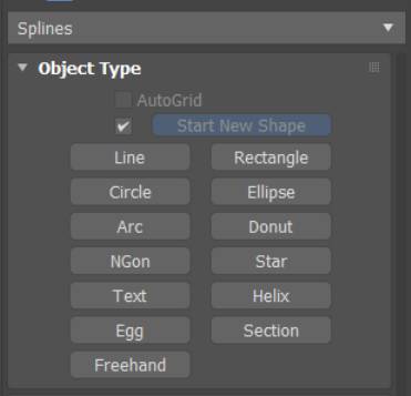

Text : Shape
text - superclass: shape; super-superclass:node - classID: #(6547, 0)
Constructor
text...
