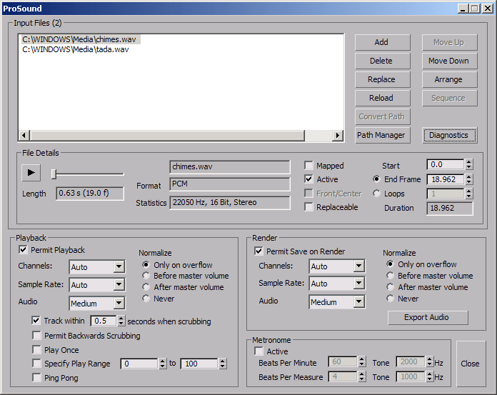

ProSound Dialog Control
<void>prosound.open ()
Opens/Maximizes the ProSound dialog.
If the ProSound is not active, it will activate it as well.
<void>prosound.close()
Closes the ProSound dialog if it is open.
EXAMPLES
   prosound.open () -- open the ProSound dialog.
   prosound.close () -- close the dialog.

<boolean>prosound.append <filename>AudioFile
Loads the specified file and appends it to the list of audio tracks. The argument must be the full name of a valid audio file.
Equivalent to using the "Add" button in the ProSound UI.
Returns true if successful, false otherwise.
boolean>prosound.delete <index>Track
Deletes the specified audio track.
Equivalent to using the "Delete" button in the ProSound UI.
<boolean>prosound.replace <index>Track <filename>AudioFile
Replaces the audio file at the specified index. The first argument is the Index of the file to replace, the second argument is the full file name of a valid audio file to replace with.
Equivalent to using the "Replace" button in the ProSound UI.
<boolean>prosound.ReloadAll()
Reloads all audio files in ProSound. Returns true if the reload is successful, false otherwise.
EXAMPLES
   prosound.append"C:\\WINDOWS\\Media\\chimes.wav"--adds a file
   --> true
   prosound.append"C:\\WINDOWS\\Media\\tada.wav"--adds another
   --> true
   prosound.numtracks() --check the number of tracks
   --> 2
   prosound.delete 1 --deletestrack 1
   --> true
   prosound.replace 1 "C:\\WINDOWS\\Media\\notify.wav"
   --> true
   prosound.numtracks() --get the number of track safter deleting 1
   --> 1
   prosound.maxtracks() --see how many tracks are supported
   --> 100
   prosound.reloadall() --reload all tracks
   --> true
