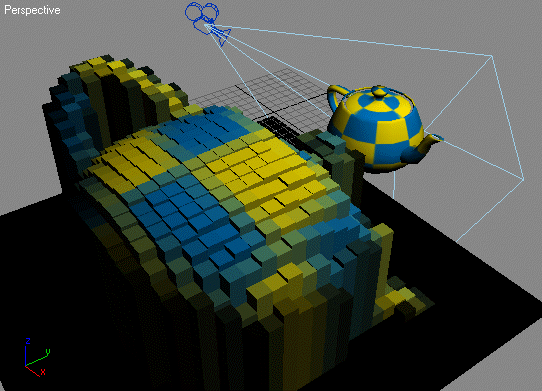

The 3ds Max scanline renderer generates a multitude of additional data channels providing information about colors, texture coordinates, normals, transparency, velocity, coverage etc. All of these channels can be accessed for reading via MAXScript.
The following simple script will render an image including Z-buffer depth info and convert it into what is known as a "voxel landscape" using the depth data to generate geometry representing the single image pixels. This script requires that geometry exists in the scene.

renderers.current = Default_Scanline_Renderer()
delete $VoxelBox*
rbmp = render outputsize:[32,32] channels:#(#zdepth) vfb:off
z_d = getchannelasmask rbmp #zdepth
progressstart "Rendering Voxels..."
for y = 1 to rbmp.height do
 if not progressupdate (100.0 * y / rbmp.height) then exit
 pixel_line = getpixels rbmp [0,y-1] rbmp.width
 z_line = getpixels z_d [0,y-1] rbmp.width
 for x = 1 to rbmp.width do
  b = box width:10 length:10 height:(z_line[x].value/2)
  b.pos = [x*10,-y*10,0]
  b.wirecolor = pixel_line[x]
  b.name = uniquename "VoxelBox"
 )--end x loop
)--end y loop
progressend()

Using the Script
To run the script, simply press Ctrl+E or select Tools > Evaluate All in the Scripting Editor's menu. Make sure the current viewport shows the desired view to be rendered. The progress bar will let you know that the script is working. The result will be a group of boxes representing both color and depth of the rendered bitmap with the upper left corner at the world origin.
