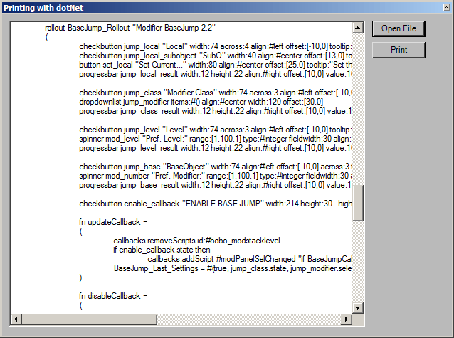

Define a MaxForm using the MaxCustomControls assembly containing a text box and two buttons.
Implement a function to print a text file to be called by the Print button's event handler.
Implement a function to open a text file when the event handler of the Open File button is called.
Register the event handlers.
Ensure the event handlers will not be garbage collected.

Step-By-Step

hForm = dotNetObject "MaxCustomControls.MaxForm"
Let's create our main form.
hForm.Size = dotNetObject "System.Drawing.Size" 640 480
We set the size of the form to 640 x 480 using the System.Drawing.Size object.
hForm.FormBorderStyle = (dotnetclass "System.Windows.Forms.FormBorderStyle").FixedToolWindow
We also set the border style of the form to the predefined value FixedToolWindow which is exposed by the System.Windows.Forms.FormBorderStyle class.
Alternatively, we could use the fact that the left-hand-side hForm.FormBorderStyle value is the same class we are assigning from at the right-hand-size, so we could say
hForm.FormBorderStyle = hForm.FormBorderStyle.FixedToolWindow
hForm.Text = "Printing with dotNet"
We set the title of the form to the string...
hForm.ShowInTaskbar = False
...and we make sure the new form does not appear in the Windows Taskbar.
txtTextBox = dotNetObject "System.Windows.Forms.TextBox"
Now we need a textbox to display the content of the file to print.
txtTextBox.MultiLine = True

btnOpenFile = dotNetObject "System.Windows.Forms.Button"
btnOpenFile.Location = dotNetObject "System.Drawing.Point" 520 10
btnOpenFile.Text = "Open File"
We will need a button to open a file to print.
We create a new button object and set its position to coordinates 520,10 inside the form. Its caption will read "Open File".
btnPrint = dotNetObject "System.Windows.Forms.Button"
btnPrint.Location = dotNetObject "System.Drawing.Point" 520 40
btnPrint.Text = "Print"
We will need another button to start printing.
We create a new button object and set its position to coordinates 520,40 inside the form. Its caption will read "Print".
frmOpenFileDialog = dotNetObject "System.Windows.Forms.OpenFileDialog"
frmOpenFileDialog.Filter = "txt files (*.txt)|*.txt|Script Files (*.ms)|*.ms|ini files (*.ini)|*.ini|XML files (*.xml)|*.xml|All files (*.*)|*.*"
In order to select a file for printing, we will need an OpenFileDialog object set to filter the typical file types.

dotNet.AddEventHandler btnOpenFile "Click" btnOpenFile_Click
dotNet.AddEventHandler btnPrint "Click" btnPrint_Click
Now we can add the two event handler functions we defined previously to the two buttons.
hForm.Controls.Add(txtTextBox)
hForm.Controls.Add(btnOpenFile)
hForm.Controls.Add(btnPrint)
We can also add the textbox and the two buttons to the form.
dotnet.setLifetimeControl btnOpenFile #dotnet
dotnet.setLifetimeControl btnPrint #dotnet

Yes, the above approach is only applicable to DotNet objects that are placed in other DotNet objects.
An example of when you have an event handler and you do not want the object’s lifetime control to change is a timer object. You want the timer object to be deleted when the MAXScript value wrapping the object is deleted. If you set the timer object’s lifetime control to #dotnet, then at some random point in the future the timer object will be deleted by the DotNet garbage collector since no DotNet object holds a reference to the timer object.
hForm.ShowModeless()
Finally, we show the form.
)--end script
Result
