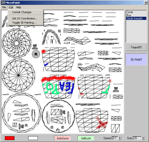

How To ... Develop a Bitmap Painting Tool - 3D Painting
In this even more exciting step of the Bitmap Painting tool development, we will add the option to directly paint on a scene object in the 3ds Max viewports.

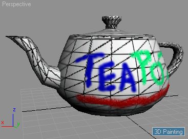

NATURAL LANGUAGE
We will add a new checkbutton to the User Interface to enable and disable the 3D Painting.
We will define a couple of simple functions using thePainterInterface to control the brush in the viewport, read the UV coordinates of the faces it is painting, and draw in the corresponding area of the bitmap.
SCRIPT:

        fn StartStroke = ( thePainterInterface.undoStart() )
        fn PaintStroke =
            theMesh = theObj.mesh
            thePainterInterface.getHitFaceData &bary &faceIndex theObj 0
            theFace = meshop.getMapFace theMesh theChannel faceIndex
            vert1= meshop.getMapVert theMesh theChannel theFace.x
            vert2= meshop.getMapVert theMesh theChannel theFace.y
            vert3= meshop.getMapVert theMesh theChannel theFace.z
            thePoint = bary.x*vert1 + bary.y*vert2 + bary.z*vert3
            drawStroke [thePoint.x * bitmapx_1, bitmapy_1 - thePoint.y * bitmapy_1] [thePoint.x * bitmapx_1, bitmapy_1 - thePoint.y * bitmapy_1]
            thePainterInterface.clearStroke()
        fn EndStroke =
            thePainterInterface.undoAccept()
            if autoSave.checked do
                save theCanvasBitmap
                try(theObj.material.diffusemap.bitmap = theCanvasBitmap)catch()
        fn CancelStroke = (thePainterInterface.undoCancel())
        fn SystemEndPaintSession = ( paint3D.checked = false )
        fn startPainting3D =
            if thePainterInterface.InPaintMode() or theObj == undefined then
                thePainterInterface.EndPaintSession()
            else
                paint3D.checked = true
                thePainterInterface.pointGatherEnable = TRUE
                thePainterInterface.initializeNodes 0 #(theObj)
                thePainterInterface.offMeshHitType = 2
                thePainterInterface.ScriptFunctions startStroke paintStroke endStroke cancelStroke SystemEndPaintSession
                thePainterInterface.startPaintSession()
        on paint3D changed state do startPainting3D()

    createDialog MicroPaint_CanvasRollout (bitmapx+100) (bitmapy+30) menu:CanvasMenu
    MicroPaint_CanvasRollout.theCanvas.bitmap = theBackgroundBitmap

rollout MicroPaint_CanvasRollout "MicroPaint"
bitmap theCanvas pos:[0,0] width:bitmapX height:bitmapY bitmap:theCanvasBitmap
colorpicker inkColor height:16 modal:false color:black across:6
colorpicker paperColor height:16 modal:false color:white
checkbutton autoSave "AutoSave" width:70 offset:[0,-3] highlightcolor:(color 255 200 200)
checkbutton airBrush "AirBrush" width:70 offset:[0,-3] highlightcolor:(color 200 255 200)
spinner AirBrushSpeed "Speed" range:[0.1,50,10] fieldwidth:30
spinner BrushSize "Size" range:[1,50,1] type:#integer fieldwidth:40
listbox BrushShape items:#("Circle", "Box", "Circle Smooth") pos:[bitmapX+5,0] width:90
pickbutton pickMesh "Pick Mesh" width:90 height:30 highlightcolor:(color 200 200 255) pos:[bitmapX+5,140] filter:mesh_filter autodisplay:true
on pickMesh picked obj do
    if obj != undefined do
        theObj = Obj
        try
            copy theObj.material.diffusemap.bitmap theCanvasBitmap
            copy theObj.material.diffusemap.bitmap theBackgroundBitmap
            theCanvas.bitmap = theCanvasBitmap
        )catch()
) checkbutton paint3D "3D PAINT" width:90 height:50 highlightcolor:(color 200 200 255) pos:[bitmapX+5,180]
This function is executed in the beginning of a stroke. See the PainterInterface documentation for details.
fn PaintStroke =
This function performs the painting of a stroke in 3D.
We take a copy of the TriMesh of the object to paint on.
Then we call this function to get the last face that was hit by the brush (last argument is face index 0 which means "get the last hit"). The variables bary and faceIndex we defined in the beginning of the script are passed "by reference" - the function will write the results into them. After the call, bary will contain the Barycentric coordinates of the hit point inside the face, and faceIndex will contain the index of the face that was last hit. theObj is the variable containing the object we selected in the scene to paint on.
Using this data we get the map face in channel 1 with the same index as the mesh face that was hit.
Next, we read the texture vertices referenced by the map face.
thePoint= bary.x*vert1 + bary.y*vert2 + bary.z*vert3
 drawStroke [thePoint.x * bitmapx_1, bitmapy_1 -thePoint.y * bitmapy_1] [thePoint.x * bitmapx_1, bitmapy_1 -thePoint.y * bitmapy_1]
Now we can calculate the UV coordinates of the hit point using its barycentric coordinates inside the face and the texture vertex coordinates corresponding to that face.
Finally, we clear the stroke.
) fn EndStroke = (
This function is called at the end of a stroke.
Accept the changes in the undo system.
if autoSave.checked do (
If autosaving is enabled,
save the painting to disk
and try to force the bitmap of the diffuse map channel in the object's material to the painting bitmap value.
This function is called when the stroke is canceled.
This function is called when the painting session ends. It will make sure the UI button is unchecked if the painting is stopped for some other reason.
This function toggles the 3D Painting.
If we are already painting or the object is not selected yet,
we end the 3D painting session and uncheck the button in the UI.
else
If the 3D paining is not active and the mesh scene object has been selected already,
we make sure that the checkbutton is pressed (as we can start this from the Main menu, too).
Enable point gathering.
Initialize the PainterInterface with just the single object that was selected.
Set the behavior for the cases the mesh was not hit to 2, which does not require a mesh. There will be no face hit and no painting in this case.
Register all previously defined scripted functions with the PainterInterface and
start the painting.
If the checkbutton was pressed by the user, call the above function.
RESULT:
You can paint on both the 3D object and the 2D image at the same time.
