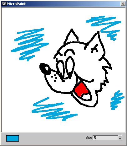

In this step of the Bitmap Painting tool development, we will add brush color and size controls.
NATURAL LANGUAGE
We will extend the existing MacroScript by adding new UI controls to the rollout to define the Ink color and the Brush Size.
The paintbrush function will be changed to use the color defined by the UI color picker.
The drawStroke function will be enhanced to draw a large rectangle based on the defined size.

Result
