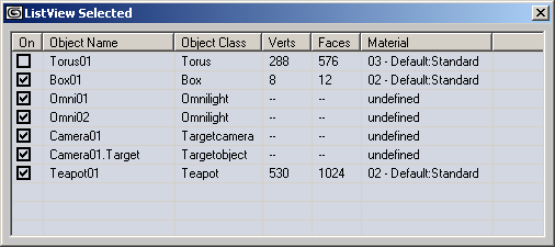

Using the Script
After evaluating the script, the SceneListView ActionItem in the "HowTo" category defined by the first part of the tutorial will be updated.
Press the button/select the menu item or press the keyboard shortcut corresponding to the SceneListView script - the dialog with the listView ActiveX control should appear. If there are no objects selected, the list will be empty.
Now select some object and watch the list updating automatically.Change the selection set again and the list will update dynamically! Select an object, right-click, go to Properties... and uncheck the Renderable checkbox. Note that the checkbox in the Listview will be unchecked, too!
