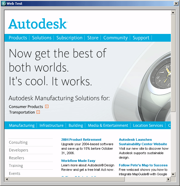

CODE
   webbrowser_rollout.wb.url = dotNetObject "System.Uri" "http://www.autodesk.com"
Now, if your computer has Internet access, the Web Browser displays the Autodesk homepage:
