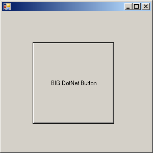

DotNet controls cannot only be placed inside 3ds Max Dialogs and Rollouts, but they can also be used to generate user interfaces implemented completely using DotNet Forms.
In the following example, a DotNet Button is created and assigned to a DotNet Form including a custom function declared as an event handler. Finally, the Form is displayed as a dialog by calling its .show() method.
SCRIPT
       fn whenButtonIsPressed a b =
           format "Pressed from a DotNet Button\n"
           format "Argument a (Form): <%> \n" (classof a)
           format "Properties:\n"
           showproperties a
           format "Methods:\n"
           showmethods a
           format "Events:\n"
           showevents a
           format "\nArgument b (Button): <%> \n" (classof b)
           showproperties b
           format "Methods:\n"
           showmethods a
           format "Events:\n"
           showevents a
       --Create a DotNet Button
       mButton = dotNetObject "System.Windows.Forms.Button"
       mButton.text = "BIG DotNet Button"
       mButton.size = dotNetObject "System.Drawing.Size" 160 160
       mButton.location = dotNetObject "System.Drawing.Point" 60 60
       --Create a DotNet Form
       hForm = dotNetObject "System.Windows.Forms.Form"
       hForm.controls.add mButton --add the Button to the Form
       hForm.topmost = true
       --Add an Event Handler for the click event:
       dotNet.addEventHandler mButton "click" whenButtonIsPressed
       hForm.show() --show the Form with the Button
