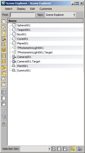

dotNetObject "MaxCustomControls.SceneExplorerControls. SceneExplorerCustomizationState"
Constructors
MaxCustomControls.SceneExplorerControls.SceneExplorerCustomizationState() MaxCustomControls.SceneExplorerControls.SceneExplorerCustomizationState <System.Int32>aColumnCount
Properties
.AdvancedFilterDataSource : <System.String>
.AdvancedFilterEnabled : <System.Boolean>
.AdvancedFilterLocation : <System.Drawing.Point>
.AdvancedFilterMatchAll : <System.Boolean>
.AdvancedFilterSize : <System.Drawing.Size>
.ChildrenCount : <System.Int32>, read-only
.ColumnWidth : <System.Int32[]>
.DisplayInfluences : <System.Boolean>
.EditingEnabled : <System.Boolean>
.FilterSelectionSetEnabled : <System.Boolean>
.FindCaseSensitive : <System.Boolean>
.FindStyleOption : <MaxCustomControls.QuickRegexFindHandler+FindStyle>
.InstanceName : <System.String>
.ParentState : <MaxCustomControls.ICustomizationState>
.SelectChildren : <System.Boolean>
.SelectDependents : <System.Boolean>
.SelectInfluences : <System.Boolean>
.ShowDependenciesEnabled : <System.Boolean>
.ShowFrozen : <System.Boolean>
.ShowHidden : <System.Boolean>
.ShowHierarchy : <System.Boolean>
.StateName : <System.String>
.SyncSelection : <System.Boolean>
.TopLevelControlState : <MaxCustomControls.FormCustomizationState>
.VisibleColumns : <System.String[]>
Methods
.<System.Boolean>AddChild <MaxCustomControls.ICustomizationState>stateObject
.<System.Boolean>Equals <System.Object>obj
.[static]<System.Boolean>Equals <System.Object>objA <System.Object>objB
 .<MaxCustomControls.ICustomizationState>GetChildByIndex <System.Int32>index
 .<MaxCustomControls.ICustomizationState>GetChildByName <System.String>name
.<System.Int32>GetHashCode()
.<System.Type>GetType()
.<System.Boolean>LoadProperties <System.Collections.Generic.Dictionary`2[[System.String, mscorlib, Version=2.0.0.0, Culture=neutral, PublicKeyToken=b77a5c561934e089],[System.String, mscorlib, Version=2.0.0.0, Culture=neutral, PublicKeyToken=b77a5c561934e089]]>aPropertySet
.[static]<System.Boolean>ReferenceEquals <System.Object>objA <System.Object>objB
.<System.Boolean>RemoveChildByIndex <System.Int32>index
.<System.Boolean>RemoveChildByName <System.String>name
 .<System.Collections.Generic.Dictionary`2[System.String,System.String]>SaveProperties()
.<System.String>ToString()
dotNetObject "MaxCustomControls.SceneExplorerControls. DefaultSceneExplorerCustomizationState"
Constructors
MaxCustomControls.SceneExplorerControls.DefaultSceneExplorerCustomizationState()
Properties
Methods

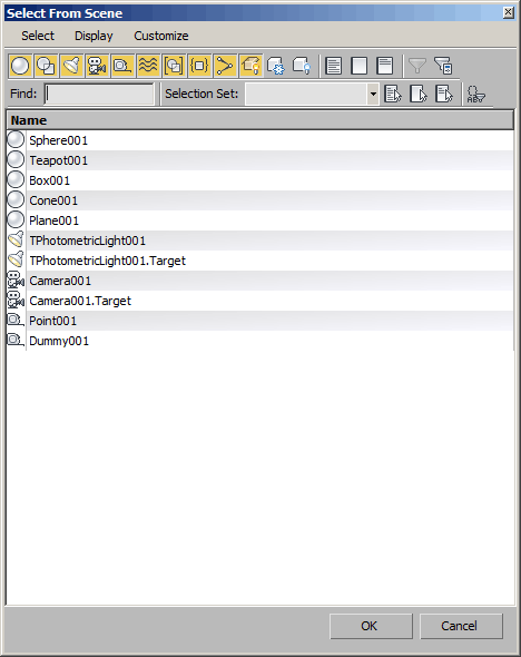

dotNetObject "MaxCustomControls.SceneExplorerControls. DefaultModalExplorerCustomizationState"
This dotNetObject implements the modal Scene Explorer dialog's Customization State including the state of various filter icons and other options.
Constructors
MaxCustomControls.SceneExplorerControls.DefaultModalExplorerCustomizationState()
Properties
Methods
