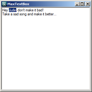

EXAMPLE
   theFrm = dotNetObject "MaxCustomControls.MaxForm"
   theBox = dotNetObject "MaxCustomControls.MaxTextBox"
   theBox.width = 290
   theBox.height = 270
   theBox.Multiline = true
   theBox.Text = "Hey Jude, don't make it bad!\r\nTake a sad song and make it better..."
   theBox.SelectionStart = 4
   theBox.SelectionLength = 4
   theFrm.controls.add theBox
   theFrm.topmost = true
   theFrm.text = "MaxTextBox"
   thePtr = DotNetObject "System.IntPtr" (windows.getMAXHWND())
   theHwnd = (dotNetObject "System.Windows.Forms.NativeWindow").FromHandle thePtr
   theFrm.Show(theHwnd)
