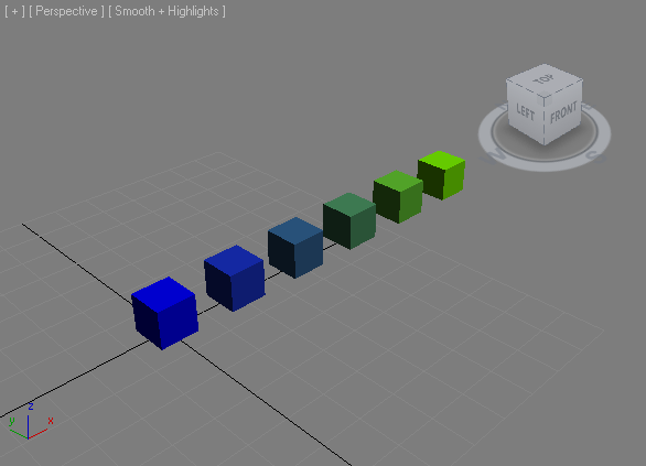

You can use a for loop to copy the box you created.
Let's expand the script we started in the beginning of this lesson:
EXAMPLE SCRIPT
   resetMaxFile #noprompt --reset the scene
   mybox = box length:10 width:10 height:10 wirecolor:blue --new box
   for i = 1 to 5 do --repeat five times, for each iteration do:
       box_copy = copy mybox --create a copy of the original box
       box_copy.pos = [i*20, 0, 0] --place it i*20 units along x
       box_copy.wirecolor = [i*25,i*50,(5-i)*50] --blue-green gradient
   )--end of the for loop
Everything inside of the parentheses makes up a "block". All loop statements must be created as a block. This statement executes five times. Each time, a new box copy is created, placed to a new position and its color is changed.

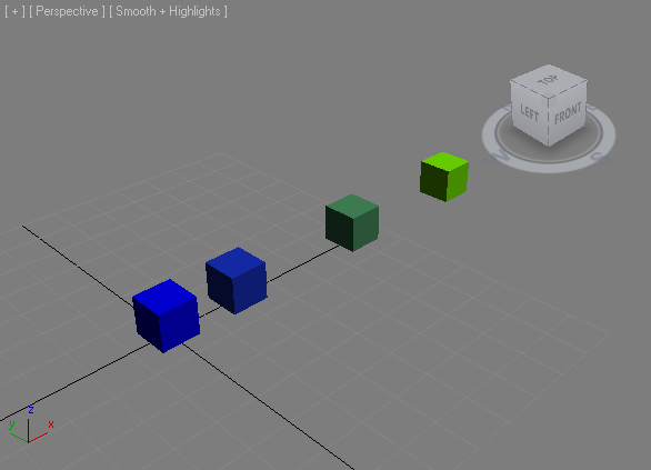

The following statement will set the index to 1, then 3, then 5,
FOR EXAMPLE
   for i = 1 to 5 by 2 do --repeat with step of 2:

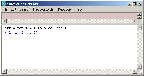

For loops can also be used to build arrays and/or access values within an array. In the following example, you use a for loop to build an array called 'arr':
Remember that because MAXScript is an expression-based language, you are able to use expressions in variable assignment, as seen above in the assignment of the for loop expression to the variable, arr.
Note the 'collect' statement in the for loop above. This tells MAXScript to collect the results of each iteration in an array, rather than just calculate them. In this case, you only asked MAXScript to collect the value of the index; however, you can collect iterations of any expression.

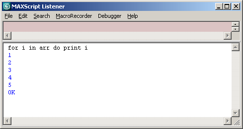

Finally, for loops can also perform iterations with the contents of an array. In the following example, you use a for loop to access the values of the array you created in the previous example:
The 'print' command is a MAXScript function that displays the specified variable in the Listener window. In this example you used 'in' instead of an equal sign; however, they are still both acceptable, even when accessing values within an array.
Note:
You can also access the number of elements in an array with the .count property.
FOR EXAMPLE
the previous example could have been written as:
   for i = 1 to arr.count do print arr[i]
This will return the same result.
