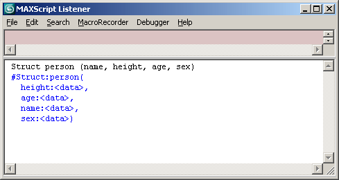

<function_definition>Create a new structure, called person:
Struct person (name, height, age, sex)

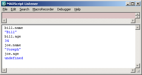

Bill = person name:"Bill" height:72 age:34 sex:#maleThis stores an instance of the person structure in the variable Bill. Member name is initialized to the string value "Bill", height to the integer value 72, age to the integer value 34, and sex to the name value #male. Create another instance:
Joe = person name:"Joseph" sex:#maleIn this example, another ‘person’ is created. However, this person does not have initialized values for the height and age members. Since you did not provide these members with an optional default value in our structure definition, they will default to a value of undefined.
