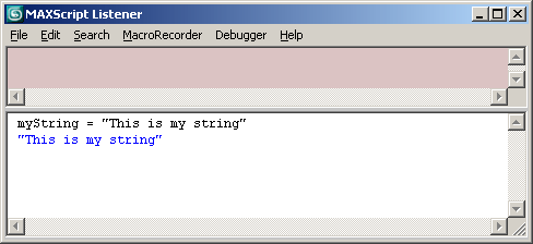

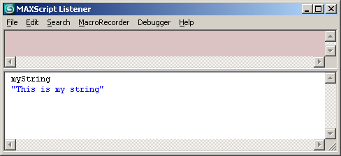

To assign a string to a variable

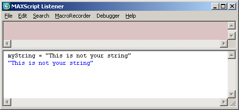

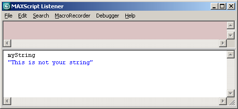

To assign a new value to an existing variable
