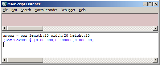

mybox = box length:20 width:20 height:20
MAXScript returns the box object name and the position of the box:
This example creates a box, and supplies three parameters: the length, width, and height of the box. The parameter names are followed by a colon and then by the value for that parameter. You can enter all parameters, without any punctuation between them.
MAXScript returns the following statement:
$Box:Box001 @ [0.000000,0.000000,0.000000].The first part of the statement is called a pathname.
c:\\3dsmax\\examples\\file.max, which represents a path through a hierarchy of directories pointing to a particular file. In MAXScript, a similar path concept is used. However paths in MAXScript end up pointing to objects, not files. Pathnames in MAXScript always begin with the "$" character. For more information on Pathnames, see the Pathname Literals topic in the MAXScript reference.The second part of the statement is the object name:Box01, in this case.
Select by Name toolbar button in 3ds Max. It is not the name of your box variable, which is mybox. This variable is merely a placeholder that points to the object, Box01.The values inside the brackets represent the x, y, and z coordinates of the center of the box.
