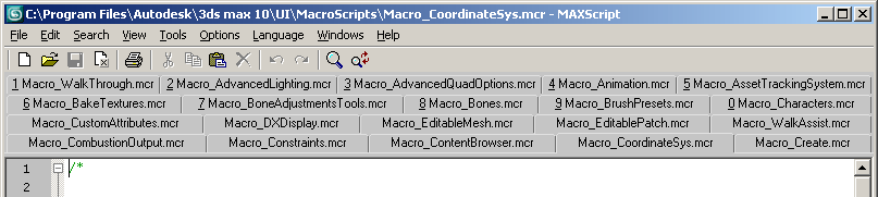

tabbar.multiline (MAXScript default: not set)
Setting tabbar.multiline uses multiple lines for the tab bar, thus fitting more tabs on screen at the same time.
Note: After changing this property, 3ds Max has to be restarted to see the effect.

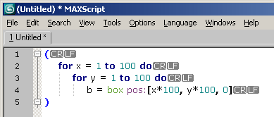

view.eol (MAXScript default: not set)
Setting this to 1 makes the Editor display the characters that make up line ends. This looks similar to [CR] , [LF] , or [CR] [LF] .
This is useful when using files created on another operating system with software that is picky about line ends.

With both set to 0, the result look like this:
if i == 10 do
    print "Yes!"
indent.automatic=1
indent.opening=1
With both set to 1, the result look like this:
 if i == 10 do
    print "Yes!"
