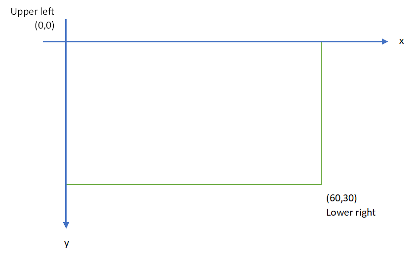

mybox1 = Box2 upperLeft.x upperLeft.y width height
upperLeft = [0, 0]
lowerRight = [59, 29]
mybox2 = Box2 upperLeft lowerRight
This will result in a box that looks like:
