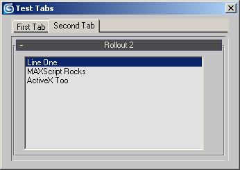

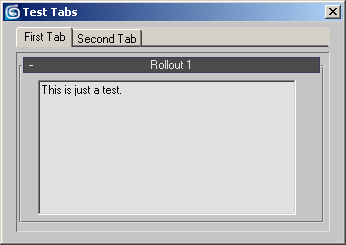

EXAMPLE
       rollout firstRollout "Rollout 1"
           edittext edittext01 text:"This is just a test." height:135 width:262
       rollout secondRollout "Rollout 2"
           listbox listbox02 items:#("Line One","MAXScript Rocks","ActiveX Too") width:260
       rollout testTabs "Test Tabs"
           activeXcontrol ax_tabs "MSComctlLib.TabStrip.2" height:20
           subRollout theSubRollout height:180
           on ax_tabs Click do
               case ax_tabs.SelectedItem.index of
                   1: (
                       removeSubRollout theSubRollout secondRollout
                       addSubRollout theSubRollout firstRollout
                   2: (
                       removeSubRollout theSubRollout firstRollout
                       addSubRollout theSubRollout secondRollout
           on testTabs open do
               ax_tabs.tabs[1].caption = "First Tab"
               ax_tabs.tabs.add pvCaption:"Second Tab"
       )--end rollout
       createDialog testTabs 340 220
       addSubRollout testTabs.theSubRollout firstRollout
