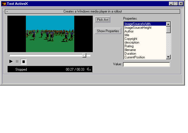

The following example creates a Windows Media Player in a rollout.
SAMPLE SCRIPT
   rollout rActiveX "Windows Media Player in a Rollout"
       local val
       activeXControl ax "{05589FA1-C356-11CE-BF01-00AA0055595A}" height:200 width:300 align:#left
       button btnPick "Pick Avi" pos:[320, 10]
       button btnProps "Show Properties" pos:[320, 50]
       listBox lbProps "Properties:" pos:[420, 10] width:170
       editText etValue "Value:" pos:[385, 170] width:200
       label lblStatus "" pos:[440, 190]
       on btnPick pressed do
           local f = getOpenFileName caption:"Pick Any Avi File" types:"*.avi"
           if f != undefined then ax.FileName = f
       on btnProps pressed do
           showProperties ax
           lbProps.items = getPropNames ax
       on lbProps selected sel do
           if lbProps.items.count > 0 then
               try ( val = getProperty ax lbProps.items[sel] )
               catch ( val == undefined )
               etValue.text = val as string
       on etValue entered text do
           try( setProperty ax lbProps.selected (text as (classof val)) ) catch( etValue.text = "Set Failed")
       on ax timer do
           sliderTime = animationRange.start + (ax.CurrentPosition * (animationRange.end - animationRange.start))/(ax.selectionEnd - ax.selectionStart)
       on ax PositionChange oldPos newPos do
           format "[%, %]\n" oldPos newPos
   nf = newRolloutFloater "Test ActiveX" 650 300
   addRollout rActiveX nf
