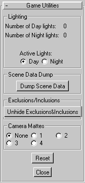

EXAMPLE
utility Infinity "Game Utilities" ( group "Lighting" ( label label1d "Number of Day lights:" across:2 offset:[10,0] label label2d "0" offset:[10,0] label label1n "Number of Night lights:" across:2 offset:[13,0] label label2n "0" offset:[10,0] label label3 Radiobuttons WhichOn "Active Lights:" labels:#("Day","Night") ) group "Scene Data Dump" ( Button scenedump "Dump Scene Data" ) group "Exclusions/Inclusions" ( Button DispExcl "Unhide Exclusions&Inclusions" ) group "Camera Mattes" ( radiobuttons CamMatte labels:#("None","1","2","3","4") columns:3 ) Button resetb "Reset" ) createDialog infinity
The Utilities panel rollout that the previous script generates looks like the following figure.
Game Utilities rollout using group user-interface item
