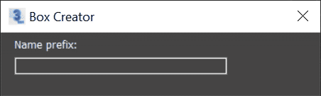

EXAMPLE
   rollout boxCreator "Box Creator"
       --define an edittextwith width 100 and the label on top:
       edittext prefix_txt "Name prefix:" fieldWidth:200 labelOnTop:true
       --If the user entered a new name...
       on prefix_txt entered txt do
           --And the name is not the empty string,
           if txt != "" do
               --Create a new box at a random position
               --somewhere between the given coordinates:
               new_obj = box pos:(random [-100,-100,-100] [100,100,100])
               --Set the name of the new object to the prefix entered,
               --but add unique suffix to avoid duplicate names:
               new_obj.name = (uniquename txt)
               --And finally clear the edittext for a new entry
               --by assigning an empty string to the text property:
               prefix_txt.text = ""
   createDialog boxCreator 300 60 --create a Dialog from the rollout
