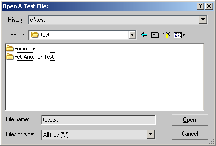

FOR EXAMPLE
   f = getOpenFileName caption:"Open A Test File:" \
       filename:"c:/test/test.txt"
   --if the path exists, will result in something like:
